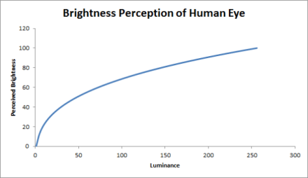

I took a look at your library and the example code and saw you avoid using floats so you might appreciate this attached program .. I adapted my fast plasma generator program I use to test my library in development to work with your library. Im curious to see the performance of your display if you or someone with a similar setup can test it. I guarantee you will think this is some pretty wicked eye candy should you try it. It has a gamma correction table, which I think I saw you were requesting somewhere.. Its very fast as it uses only integer math and some other tricks for trigonometric calculations.

//uncomment the following to enable gamma correction
//r=pgm_read_byte_near(exp_gamma+r);
//g=pgm_read_byte_near(exp_gamma+g);
//b=pgm_read_byte_near(exp_gamma+b);
