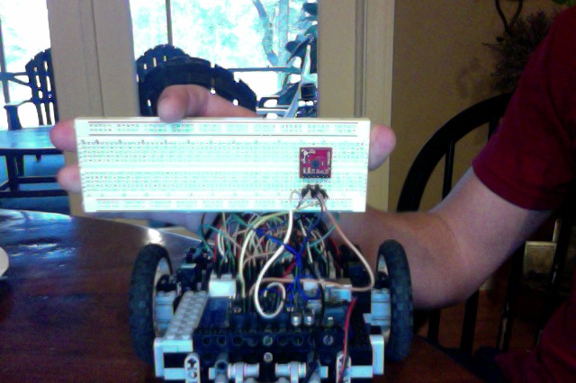

Yes, your way of using the AREF is correct. For the large fluctuation, I am suspecting poor contact between the output and the input. Are you using a breadboard arduino? How are you connecting your wires? Pictures will save 1K words.
Since it's an analog accelerometer, the easiest way to test it is to connect the power (3.3v) to the accelerometer and put a meter on the X, Y and Z pins. If the readings are stable on the meter and vary according to tilt then you can be fairly sure the accelerometer is working and the problem lies in your interface. If the readings are not consistent with what the datasheet says then there is a problem with the accelerometer.

liudr:
![](http://Photo on 11-10-11 at 7.53 AM)
The power pins are attached to the GND and 3.3v ports. The analog pins are attached to their respective ports from the program. ST is not hooked up.

I tested each pin with my voltmeter. Y did not give any signal at all; so there's the problem! Thank you all for your help. I appreciate it.
It could be just a bad connection on the Y pin. Another thing you can try is to connect the ST pin to 3.3v and see if you measure -0.325, +0.325 and +0.550 respectively on the X, Y and Z axis. That will tell you if it's a problem with one or all the axis.
