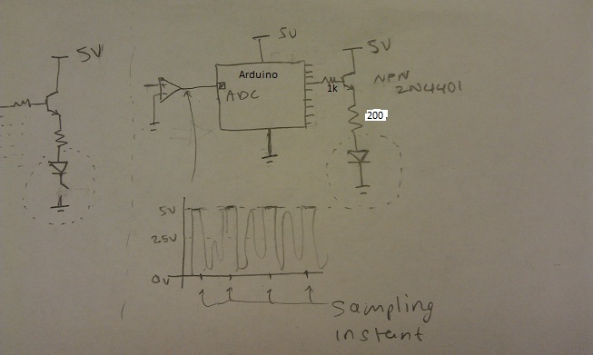

The circuit in the following condition with the LED ground connections open, as seen here, works fine. The Arduino reads in values like its supposed to picking up any sound into the mic. I verified this by doing a serial print of the values to my computer and also probing the output of the the opamp into an oscilloscope.
Simplified circuit.
The problem arises when I close the LED ground connections as seen in the following picture. Oddly enough, the ADC seems to be giving a square pulse at the instant it samples the signal. I verified this by probing the output of the opamp into an oscilloscope: the graph below the circuit shows what I saw on the oscilloscope. The ADC is reading a value of 1016 (almost 5 V) which turns on all the lights perpetually.
Simplified circuit.
To further complicate things, when I reduce the voltage supply to the entire circuit (including the microcontroller) down to about 3 V, the odd behavior described above does not happen and the VU meter functions perfectly! But at this voltage the lights are too dim and barely visible ![]()
