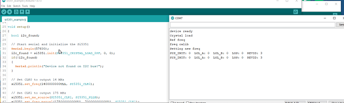

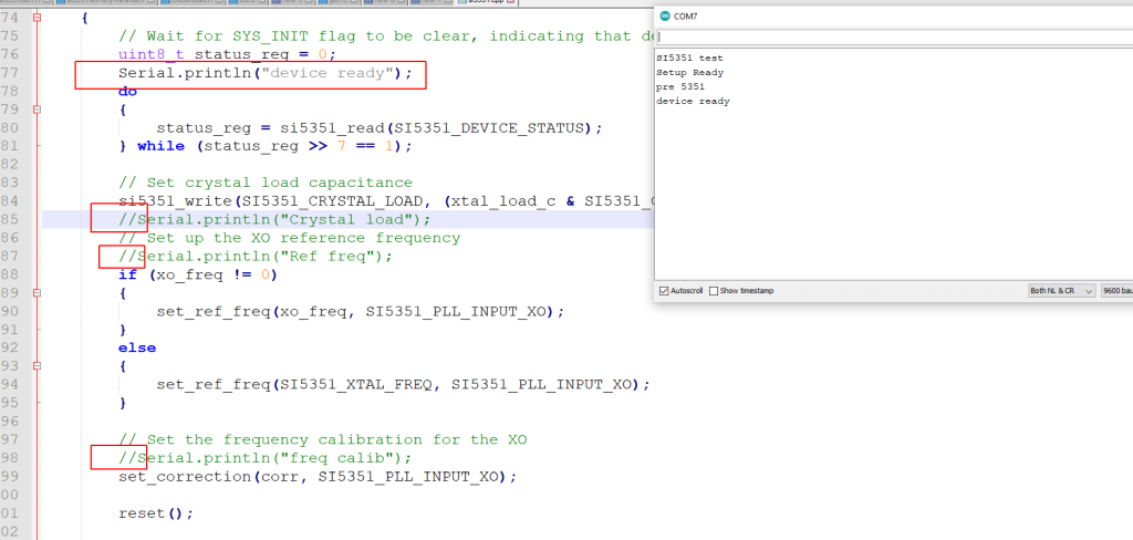

It would not be useful to show my code because it compiles and runs fine on a different PC/IDE. But these two screen caps show the problem.
First: On the left is a snippet from the stable Etherkit si5351.cpp library showing the print statements I added for debugging. Note only the "device ready" print is enabled and on the right you can see the correct expected serial monitor screen display:
Next: I made one edit to the source, removing the comments for the first print debug line immediately after the library writes the crystal load data to the device register via I2C. Note that I2C communications has already been tested because the first screen cap above shows that "Device Ready" was displayed. But as the serial monitor screen on the right show, after the call to the library function the display goes nuts, scrolling the reverse-? symbol so fast I couldn't capture the start of it. But this scrolll will continue ad infinitum.
To repeat, the only difference between these two screencaps was the enabling of the Serial.println immediately following the library function call. I would add that the code size (.hex file) is different than the file size created by the 2nd PC which produces good code. And because the hardware has an OLED display I can also visually see that it does not get past this point in execution - whatever is going on takes the CPU off into never-never land.
Just to prove there is nothing wrong with the library function, here is a similar screencap from an example provided by the library author which uses the same exact function, and in fact it executes properly with the expected screen display on the right:
Regarding baud rate, all the Serial.println debugging in my sketch is done at 9600 baud. The last screen from the example was set to 57600 baud by the author and I left it that way, so of course I had to change the serial monitor to match. But this is not as simple as a baud rate problem.
Whatever is going on, it is unique because the same library function will execute properly in a different sketch. That's what makes me suspect that the IDE is perhaps associating the wrong code with the si5351.h header causing stack corruption.
Copying my sketch over to a different PC with an older version of the IDE will compile and flash the sketch perfectly. What I'm trying to figure out is how to fix whatever is wrong on the first PC/IDE, thanks.
