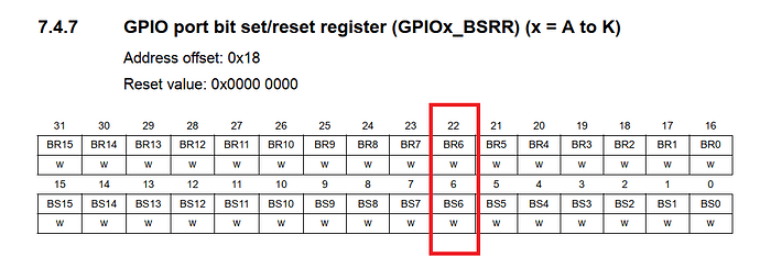

Depending on what the default (RESET) states of the registers, you can "SET" or "CLEAR" their corresponding MODER register
In this example, to change PINA6 after reset
// OUTPUT MODE
GPIOA->MODER |= 1<<12;   // PIN6 is in MODER6[1:0]
// ALTERNATE FUNCTION
GPIOA->MODER |= 2<<12;   // PIN6 is in MODER6[1:0]
// ANALOG
GPIOA->MODER |= 3<<12;   // PIN6 is in MODER6[1:0]
Then use the BSRR register to "SET" or "RESET"
// CLEAR or RESET
GPIOA->BSRR = 1<<22;
// SET
GPIOA->BSRR = 1<<6;
You have to check the GPIO section of your MCU manual
