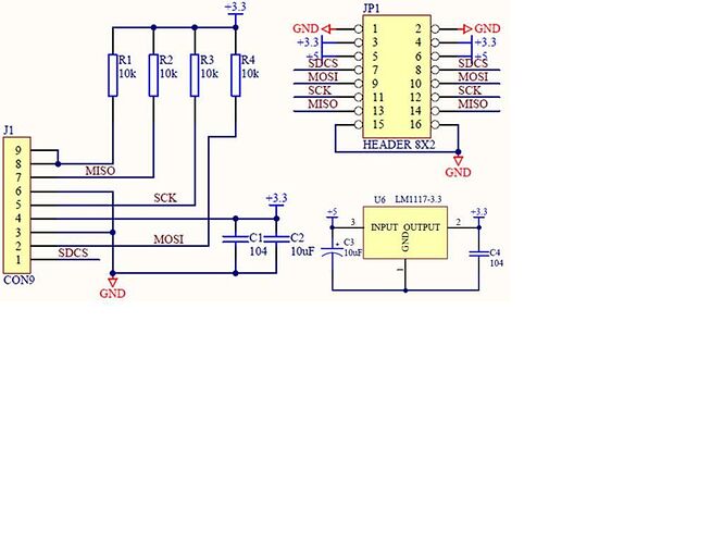

I needed a cheap implementation SD recorder for a 9600 BAUD stream from my Mega2560. The Mega is running dual SPI instrumentation amplifiers for exhaust gas thermocouples, I2C for realtime clock, and bunches of analog inputs for fuel level, battery current, cabin temperature, ambient air temperature, 2 ports for cylinder head temps, and the list goes on. In addition to acquiring data, the Mega is managing two 16x2 line OLED serial displays. Adding SD card log recording to this code seemed a bit foolish. And so I went looking for alternatives and found them starting at $40 and running to $70 for generic recording. I was not impressed.
The SD card breakout board the plane owner purchased was the LC Studio card, discussed in the forum elsewhere and in a somewhat dim light. But I had it, so I figured I at least needed to try it before telling my friend to shell out cash for the AdaFruit or SparkFun it alternative shield plus more for an UNO to mount the shield.
I found the schematic for the LC Studio board from a link in this forum. The 3.3V linear regulator can manage 700mA plus. The idea of a naked ATmega328P-PU being back fed from the 3.3V regulator on the SD card breakout began to develop. No SPI level shifting! Dealing with the incoming serial data from the 2560 is easily done with 2 resistors.
I started the prototype and utilized the <SD.h> library in Arduino 1.0.1. The final design implements a program buffer if 512 bytes and the buffer is purged when full or when a CR is received in the stream. The CR implementation was programmed to minimize any data line losses from my logging implementation in the 2560.
The final beta code will log a substained serial stream at 9600 BAUD without character loss. The unit may go higher, but I met my design goal and my FOX character generator is switchable from 4800 and 9600 only.
The beta code, pictures, and write-up are published below. Remember, this circuit is running at 3.3V, so you will need to use level conversion for the serial input line, or a zener, or a resistor bridge to reduce the TTL signal to a 3Volt swing. There are many examples of how to do this on the Internet, but a good discussion is also here:

Any chance you could post larger copies of those 2nd and 3rd images?
The thought of using 2 x mcu in a project appeals greatly. I think the most recent Gallery post had a larger than life robot using 7...
I personally would have wrote interrupt-driven UART logger what you can do is in your main loop check if a buffer reaches a certain threshold and if so write the bytes to the sd card just be sure not to use SD.h a second microcontroller should be a last resort.

i am very keen to see your libraries, and have some SD card break out boards too, now. will be interesting to see what speed i can get. SPI will be good too, as I need S0 for control, S1 (115200) & 2 (9600) for serial data comms and S3 for bluetooth comms.
Updated: The '462 Image is a 328 Flattened running at 8MHz @5V. The decoupling cap is soldered to the bottom and the chip is driving a 2x16 parallel LCD… only the pot for the contrast and the reset button are required additions! I’ve done the same with the Nokia display which does not use the potentiometer and the reset is kinda optional… So just the 328P-PU and the bypass cap… I think I have hit rock-bottom in minimalist part usage. The software running is Magic Morse and the circuit works flawlessly from 5WPM to 40WPM.
Certainly!
