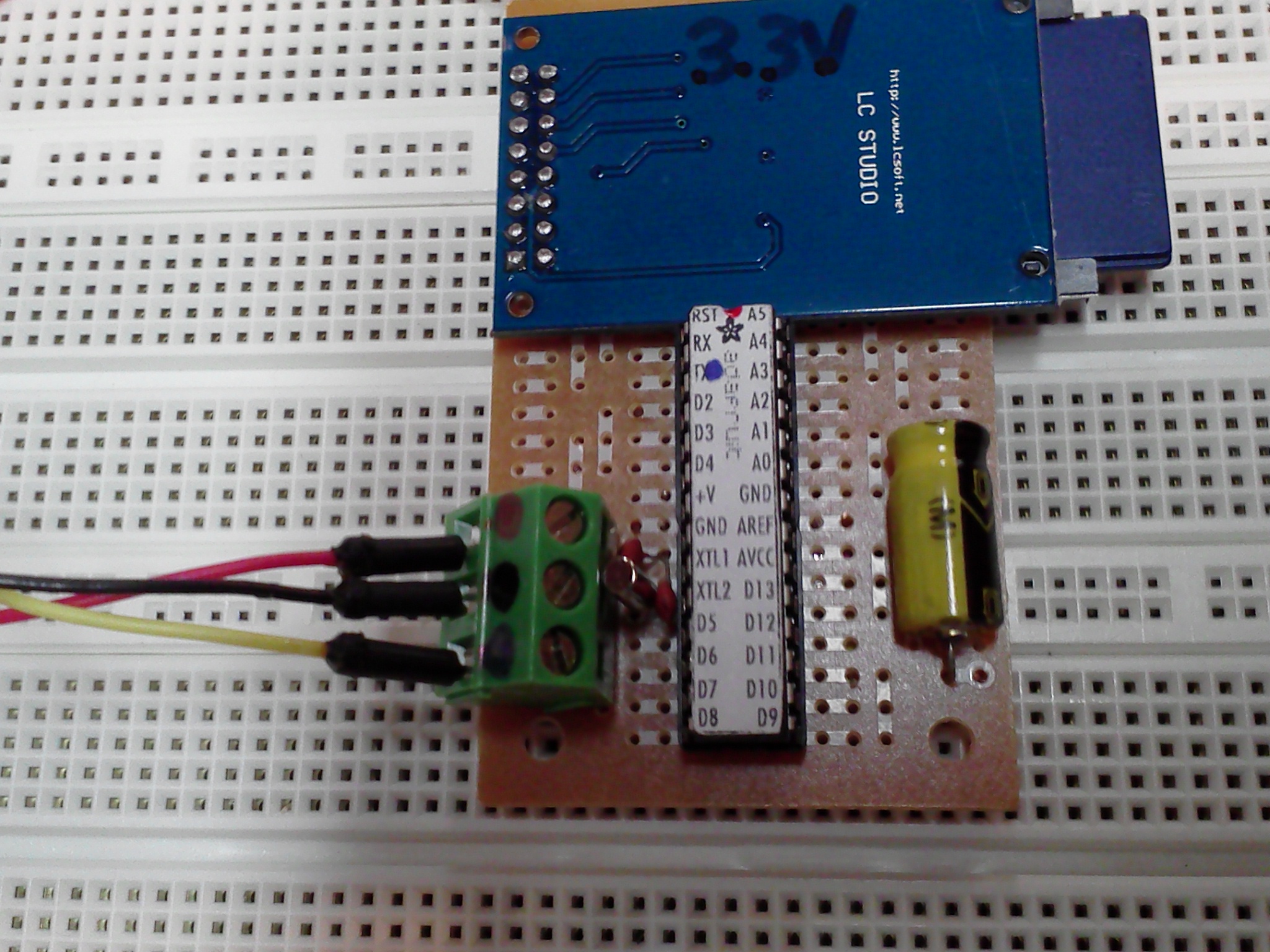

off load serial data recording to dedicated 328P and SD card

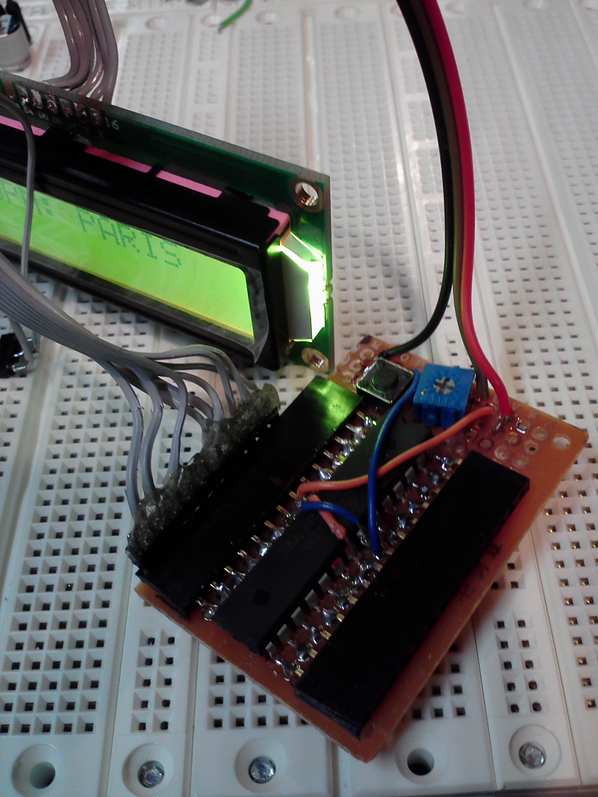

Updated: The '462 Image is a 328 Flattened running at 8MHz @5V. The decoupling cap is soldered to the bottom and the chip is driving a 2x16 parallel LCD... only the pot for the contrast and the reset button are required additions! I've done the same with the Nokia display which does not use the potentiometer and the reset is kinda optional... So just the 328P-PU and the bypass cap... I think I have hit rock-bottom in minimalist part usage. The software running is Magic Morse and the circuit works flawlessly from 5WPM to 40WPM.
Any chance you could post larger copies of those 2nd and 3rd images?
Certainly!

I personally would have wrote interrupt-driven UART logger what you can do is in your main loop check if a buffer reaches a certain threshold and if so
Ray says,
"It's Open Source..." It's a dedicated $2 chip... Interrupts (in user code) are really not needed to service the serial stream (at least not in my testing at 9600 BAUD.) I did not measure uC processor bandwidth, but I did throw my 9600 BAUD 'Quick Brown Fox' generator at it and did not lose any characters in the incoming stream. I built this as part of an experimental plane (Europa) engine monitoring system... the pictures are of the prototype. My friend and plane owner builds his own circuit boards so I don't waste my time anymore, but I did start using stripboard because my friend always keep my solderless breadboards (someday, they will return...)
The code may make more sense if you realize that the Mega2560 main Arduino logs output to this logger every 10 seconds (OLEDs refresh rate). The messages are diagnostic in nature but also have all of the OLED values from the engine sensors. Therefore, it was desired to always update physically to the SD with each message. Hence the reason that the buffer is checked for being full or CR:
if (c == '\r' || (bufferidx >= BUFFSIZE-1)) {
The bulk of the setup ugliness is due to managing the insertion state of the SD card and using the colored LEDs to make some sense of the states. If you do not like blinky lights, perform surgery. XD
Ray
  Datalogger by M. Ray Burnette
  Designed for use in Europa Mega2560 airplane engine monitor system
  Target Atmel328P-PU @16MHz (3.3V so slightly out of spec.)
  Binary sketch size: 13,838 bytes (of a 30,720 byte maximum)
  Tested with Arduino 1.0.1
