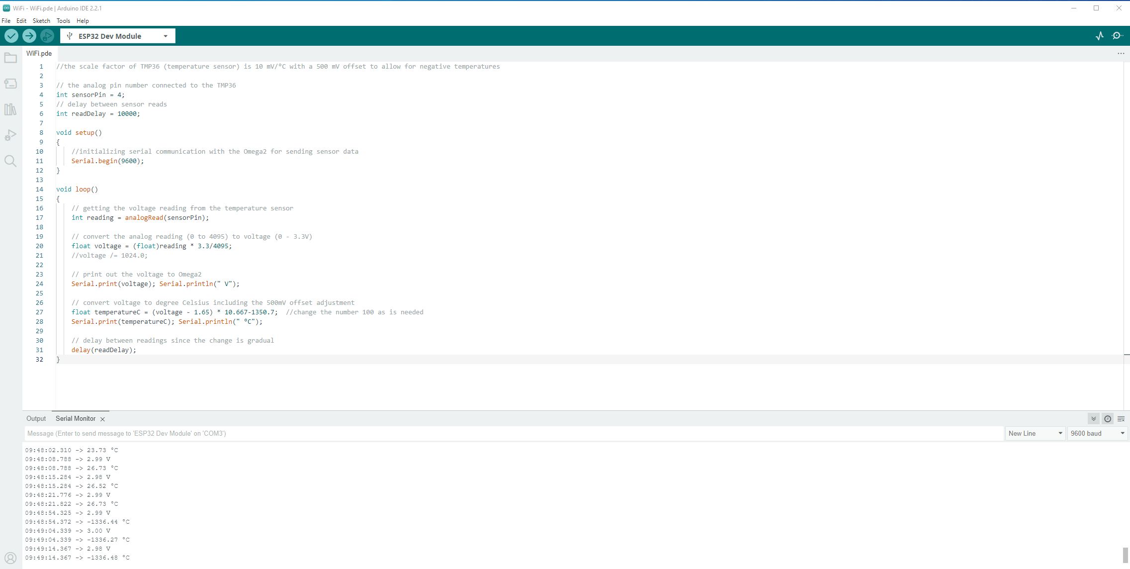

has not mentioned the aim or the issue you are seeing. There is a couple of photos or screen shots which most people ignore.
There appears to be a sketch to convert an analog reading to real voltage, and a resistor.

Message (Enter to send message to 'ESP32 Dev Module' on 'COM3')
12:41:05.593 -> 1.33 V
12:41:05.593 -> 83.29 °C
12:41:12.599 -> 1.32 V
12:41:12.599 -> 82.40 °C
12:41:19.596 -> 1.32 V
12:41:19.596 -> 82.24 °C
12:41:26.556 -> 1.32 V
12:41:26.588 -> 82.24 °C
12:41:33.596 -> 1.32 V
12:41:33.596 -> 82.08 °C
12:41:40.592 -> 1.32 V
12:41:40.592 -> 82.40 °C
12:41:47.573 -> 1.29 V
12:41:47.573 -> 79.02 °C
12:41:54.592 -> 1.32 V
12:41:54.592 -> 81.84 °C
Not getting an accurate read ambient temperatures are far off and it is very slow to respond my ambient temperature is about 24 °C not 81.84

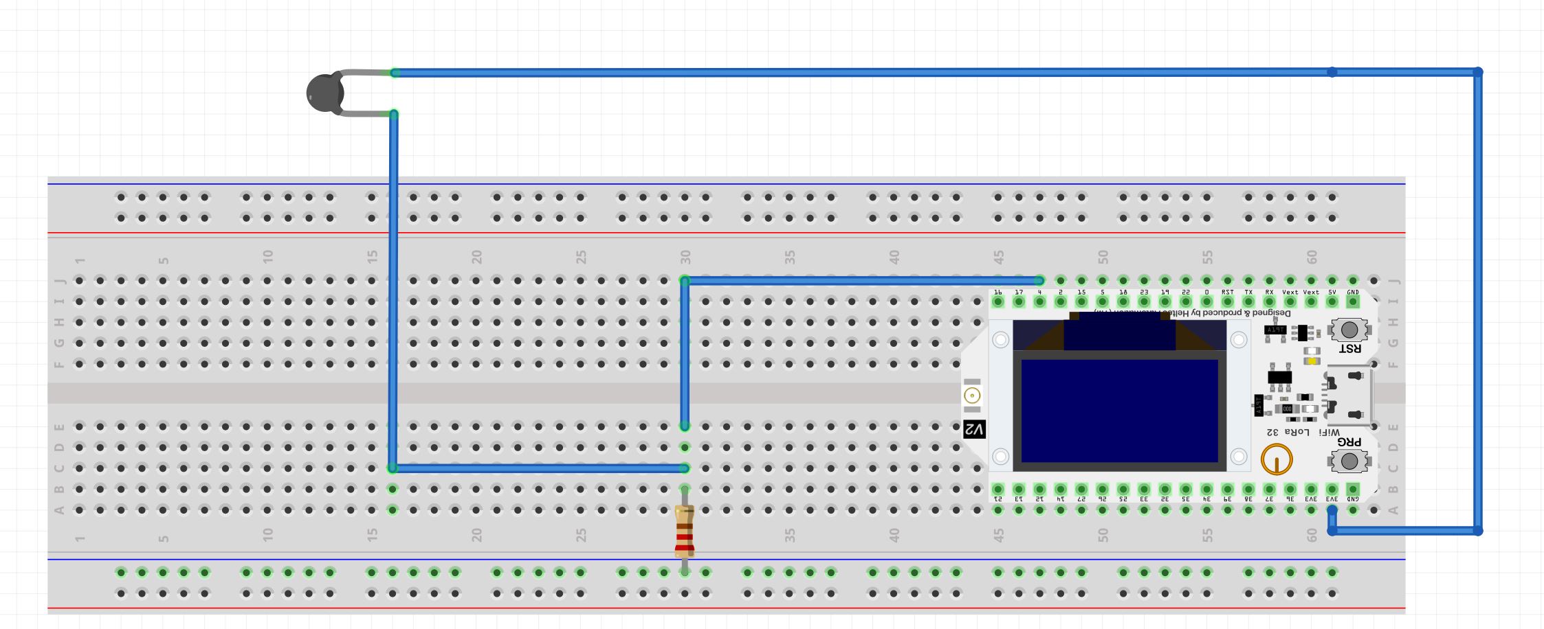

It might be better for you to draw out a circuit diagram of how you have it connected.

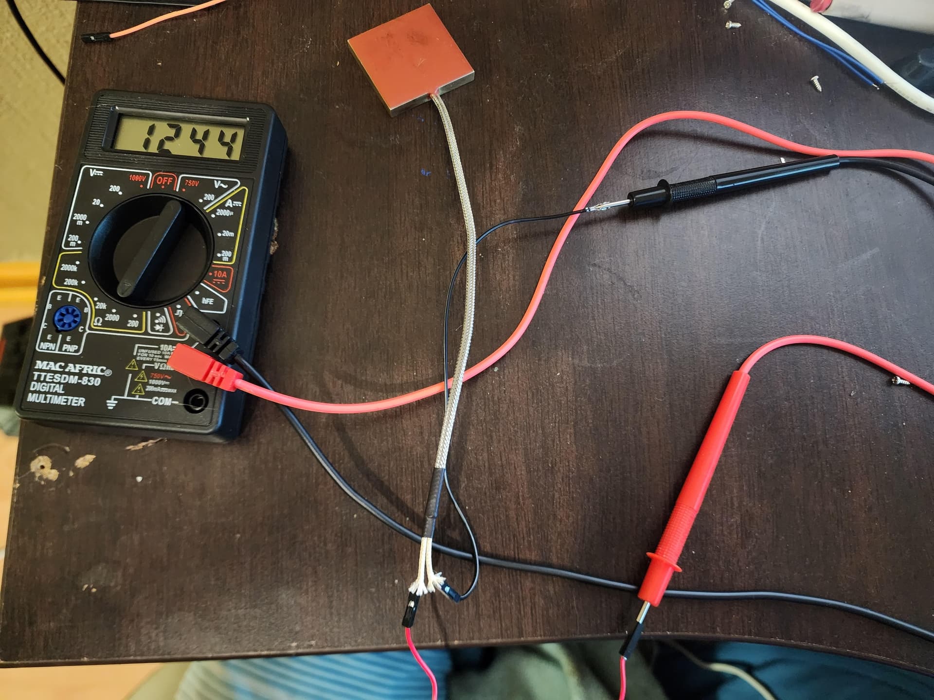

Kola resistance on the sensor without the circuit is 1096 OHM i can post a picture i will try to draw the schematics and post it to you guys.
the 3rd pictures states the sensor info under product parameters

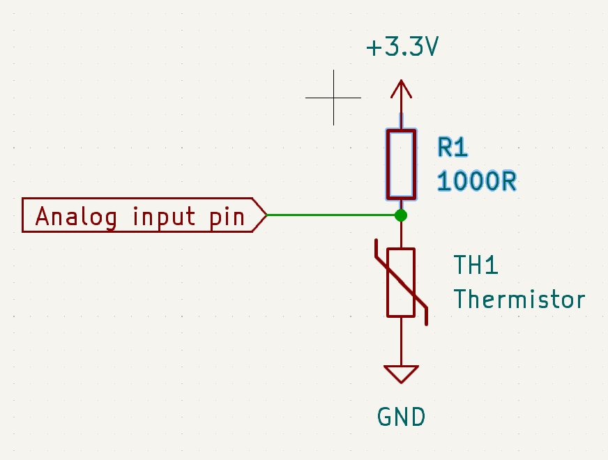

Do you intend to have this:
EDIT
I believe there is confusion there over the use of the power supply module at the end of the breadboard. Until this works, stick to powering the ESP from the USB and the circuit from the ESP pins.

this is impossible. measure both, constant resistor and PTC.
schematic not correct, no GND. and pls don't use fritzing
Well until we know more I think you should use a 1k resistor, change it around to the diagram I provided where the resistor is acting as a pullup and the sensor connects to 0v. This is so when you end up with a finished product you are not sending the 3.3v supply out on some long wire to the sensor, to pick up noise like an antenna or short to something else. There's more to do in this regard once you get it working.

Constant and when you heat it up obviously it increases the hotter it becomes the more it increases got it to 1650 previously.
(and pls don't use fritzing)
Any alternative??
since this is no good to you?
KiCAD.

You have your DMM setup wrong for resistance
Should be going to the Com plug i think.
Read that………….
