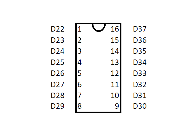

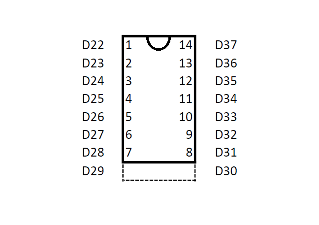

Ok i got this code from github https://github.com/dattadebrup/Digital-IC-tester/blob/master/ictester/ictester.ino
I am trying this code but i want to show the results on a serial monitor instead of a lcd and i do not know what to change in the code so i don't mess it up

int pin(int n)
  if(digitalRead(48)==HIGH)
    //16 pins
    n=n+21;
  return n;
    //14 pins
    if (n>7)
      return n+23;
      return n+21;

I have ran the code in arduino, there is no error but there is also nothing in the serial monitor
Do you have the hardware the code was written for and the schematic showing how the various components are interconnected? If not, I don't see the use of having the code.
did you press the button and have the switch in proper direction??
i get allot of "not founds"..
Mega IC Tester..
good luck.. ~q
oh i thought i just had to connect according to the pins sorry.

You need to have a 16 pin ZIF socket connected to the correct Arduino digital pins in order to connect the IC under test.
I've worked out the pins used from the following snippet of the code:
int pin(int n)
    //16 pins
    n=n+21;
  return n;
    //14 pins
    if (n>7)
      return n+23;
      return n+21;
You need to connect the 16 pin ZIF socket as follows:
IC Tester ZIF Socket - 16 pin IC
If the IC under test is a 14 pin one, you fit the IC in the socket as follows:
IC Tester ZIF Socket - 14 pin IC
You need to have a switch connected to Arduino pin D48 to select how many pins your IC has.
LOW for 14 pins, HIGH for 16 pins.
  //14 pin ICs
  if (digitalRead(48)==LOW)
There may be other things you need that I haven't yet discovered.
