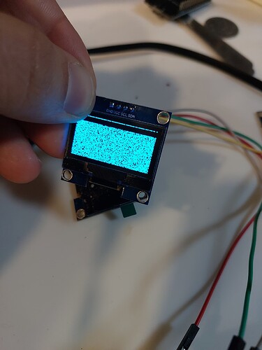

OLED example sketch works on small OELD but same model in larger size acts strange
The small OLED works, the slightly larger ones dont.
This is my code:

It would appear that the larger OLED doesn't use an SSD1306 controller. You'll have to include the library that matches whichever controller it uses.
