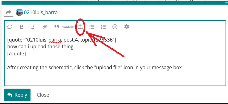

sorry for the question but how can i upload those things here.
Trough a photo? of the schematics?
i also checked that thx
After creating the schematic, click the "upload file" icon in your message box.
Pen, paper, foto and upload, yes.
I already post thx
You need to show pin numbers of the pins being used on every device.
Fritzing type pictures are not appreciated as too much is missing, circuit pin numbers unreadable, missing power supplies etc.
