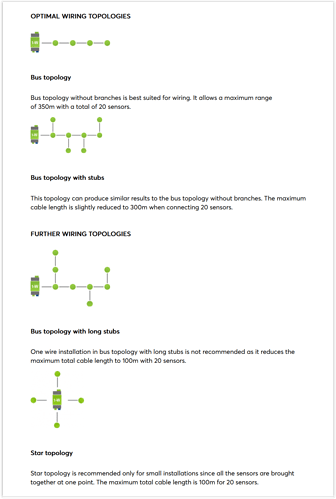

I assume the wiring is bad. The first is the best choice. The star is the less good wiring.

About the wiring: Yes, I have more or less the first “optimal” wiring, except for the last 2 temperature sensors, as said.

I think I cannot use CAT5 cable, since the pieces from one to the next of the first 5 temperature sensors is only approx. 15 - 20 cm but with only very little space! And the last 2 ones are waterproof from Adafruit with their used cabling defined from their production.

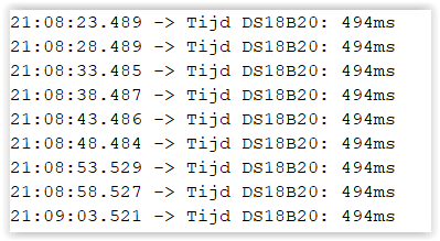

Tested today. Normal program 11 bits delay 375ms.
Always 494ms delay with no temperature change

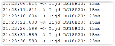

With this in setup:
sensors.setWaitForConversion(false);
15ms without changed temperature and 23ms with changed temperature that must written on an oled screen.

About your net: It appears to be light and with a small radius (using terms from https://www.maximintegrated.com/en/design/technical-documents/tutorials/1/148.html ).
Although I'm not quite sure how to understand: "only 7 sensors, in total about 3 meters apart". , because it's not clear how far all of these are from the Master (your Arduino). But if indeed your entire network has both a radius and weight of a few meters and a line topology, then indeed there should be no problems with it. However, since the reality is that it is operating at the limit of stability, as evidenced by the summer/winter effect you described, i.e. the effect of changes in temperature, humidity, etc. on device timings or on physical interrupts - e.g. "cold solders" as suggested by colleague Nick Pyner, I think the cause of your problems, however, lies in the hardware (and not in the code), and implementing my suggestion can get you the fastest way to catch the cause of such a condition (and importantly: without interrupting the operation of the installation you have already built !). If you create a second line, to which you'll rewire, for example, your 2 airtight sensors, and run it together with the first line*, you'll find out the fastest way to find out if there are errors, and if so, where. Then you can decide what to do next, such as whether to rewire more sensors. If you would decide to build a second line, first check if your libraries will allow you to set up 1-Wire instances successfully. (If not, and you absolutely want to stay with your libraries, you can use the simple relay solution I wrote about previously on an ad hoc basis for testing). And one more thing: in accordance with what Nick Pyner wrote earlier, spare "a few cents" and make the 2nd line on the only wire currently recommended for 1-Wire: unshielded twisted pair (UTP) category 5e, running SIGNAL in 1 pair with GND. I don't elaborate on the details: everything is described in detail in the sources at the links I provided in the previous post (the 2nd material includes a drawing explaining what "signal in 1 pair with GND" means, if you had any doubts).
    • What is the shortest distance between the existing 1-Wire line and the motor you write about ? (Because maybe, building the 2nd line immediately significantly distance it from the motor ?)

First of all, thank you, too, for this great idea, to split the network into 2 parts with the 2, more far sensors, attached to a separate pin on the uC and the other closer 5 ones on another uC pin, in order to find out which one is the “guilty” part. As I have said already I definitely will also follow Nick Pyner’s - at the end concrete - suggestion, to use the proven code from “Hacktronics” as a new starting point for my software and and do my add-ons one after the other.
As I already have written, “The sensors are almost all in "line" configuration and the first 5 are just 15 - 20 cm apart (still in "line" !), the last 2 sensors are just approx. 3 meters away (2 meters out of the 3 are in "line", so one common cable and the approx. last meter divides the 2 sensors, so being each approx. 1 meter away from the common point).
As said, there is no way to do CAT5 cabling or similar, because in the first line with the 5 sensors, I simply do not have the physical spacing (even the connectors would be much too big!) and 2nd line with the other 2 sensors must have the given water-resistant cabling, so also there I cannot change the cable.
But as said: Following and combining (how to do that, I will see, hopefully) both recommendations (from you: Make two 1-wire lines to different uC pins, and from Nick Pyner: start with the proven “Hacktronics” code), should bring me a step further. But this will take quite some time.
By the way: The shortest distance between a part of a 1-wire network “crossing” the motor are maybe 2 cm, as one of the temperature sensors is directly connected to the hot output copper metal “tube” of the compressor in order to measure the hottest point in the whole system.

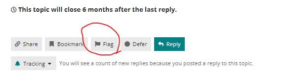

Please flag the original thread....Describe why want it open, then you can continue your discussion.
Dear theeccentricgenius,
Thanks for your answer! I think with "flag" you mean, I shall copy the link to the original topic?!
I would like to re-open, since I did not have time to follow up the suggestions from the forum people, and I did not remember that a topic will be closed after 6 months (in other forums I did not experience such an automatic time-out).
Now, I wanted to concretely apply a code from a forum user, but in my case it does not work, although, according to the user, as far as I understand it at least, should work.
Will you then re-open that orig. topic for me?
Thanks a lot,

Sorry, can't not a mod or leader.
Flagging is clicking the flag button at the bottom of the topic or post.
