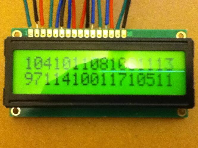

Only numbers on screen, no characters
Hi all,
Yesterday i bought my first arduino (uno), I got led blinking and fading working, but I still had a 16x2 character display lying around here. So I thought; hey can i maybe use this in combo with my brand new arduino and that program called LCD smartie? :slight_smile: After a few minutes of google i found this thread: http://www.arduino.cc/cgi-bin/yabb2/YaBB.pl?num=1256721775
I followed all the steps in the thread but all i got was this:
What there should be is: Hello
Arduino
Problem is: I'm a complete noob but i want get this to work. LCD smartie is communicating with the arduino ( I can tell by the RX light)
I hope someone knows a solution. Thanks
Also don't mind my bad soldering :stuck_out_tongue:
Seeing your code and your circuit would help
Looks like you are printing characters as integers.
104 h
101 e

It looks like that is the problem. But as is said; im a noob. So what do i have to change now to get it to work properly?
Hard to say what to change without seeing the code but you could try adding the ", BYTE" in your print call.

Try changing
lcd.print(rxbyte); //otherwise a plain char so we print it to lcd
to
lcd.print(rxbyte, BYTE); //otherwise a plain char so we print it to lcd
johnwasser:
Try changing
to
but BYTE does not exist in Arduino 1.0
(Another one of those non backward compatible changes in 1.0)
So it is safest to simply cast rxbyte (which is declared as an unsigned char)
as a char so it works in both pre 1.0 and 1.0
lcd.print((char)rxbyte);  //otherwise a plain char so we print it to lcd
or directly call the write() routine:
lcd.write(rxbyte);  //otherwise a plain char so we print it to lcd
using write() on pre 1.0 will eliminate the printNumber() routine which really isn't needed
in this case.
This is an area that changed from pre 1.0 to 1.0
in pre 1.0, calling print() with a char or a an unsigned char and no "base" qualifier argument behaved the same.
(The "base" was BYTE or 0, which meant print it a character).
In 1.0 the default "base" for an unsigned char is now DEC or 10 which means unsigned chars print as
a decimal number rather than a character.
--- bill
It works!! Thanks.
