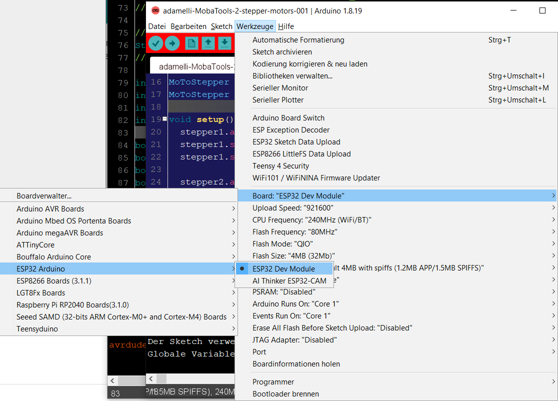

what version of board-support for ESP32 are you using`?
I'm using 2.0.7
I use this additional board url
https://espressif.github.io/arduino-esp32/package_esp32_index.json
no idea what you want to say with that
If you like to post pictures for entertainment go snap-chattering
2.7.4 I take it is the version (in the picture). I'm just going to try to get AccelStepper to work. I've spent way too much time on the other library now.

I compiled the given demo-code
#include <MobaTools.h>
const int dirPinX = 0;
const int stepPinX = 2;
const int dirPinY = 19;
const int stepPinY = 18;
/* ====== minimumStepper =======================================
 *  Bare minimum to get a stepper with step/dir driver turning
const int stepsPerRev = 200;    // Steps per revolution - may need to be adjusted
MoToStepper stepper1( stepsPerRev, STEPDIR );  // create a stepper instance
MoToStepper stepper2( stepsPerRev, STEPDIR );  // create a stepper instance
  stepper1.attach( stepPinX, dirPinX );
  stepper1.setSpeed( 300 );              // 30 rev/min (if stepsPerRev is set correctly)
  stepper1.setRampLen( stepsPerRev / 2); // Ramp length is 1/2 revolution
  stepper2.attach( stepPinY, dirPinY );
  stepper2.setSpeed( 800 );              // 30 rev/min (if stepsPerRev is set correctly)
  stepper2.setRampLen( stepsPerRev / 2); // Ramp length is 1/2 revolution
  stepper1.rotate(1);                    // start turning, 1=vorward, -1=backwards
  stepper2.rotate(1);                    // start turning, 1=vorward, -1=backwards
best regards Stefan
