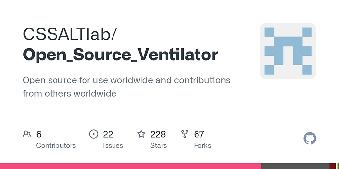

I joined a team that stated at Florida-U to build an Open Source Ventilator. Project is underway with dedicated PCB prototypes already being assembled/tested. More details about the overall project at:
The code uses a low cost LCD and 3 buttons as UI. It tracks pressure sensors and drives a stepper motor.
As Florida-U uses existing positive pressure sources I have not yet added stepper motor feature but I am looking for a team that needs to control a squeezer mechanism. We could join forces to build/test/improve this feature.
Code is GPL-3 licensed. Be free to clone/branch our repo:
More specific:
https://github.com/CSSALTlab/Open_Source_Ventilator/tree/master/ControllerSourceCode
