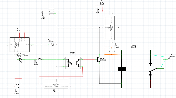

Hi guys,
This is my second project i made. Though the first project was from a relay module that was already set up. Now i've tried to do some research and set up things like they are showing now.
I am going to connect a 12v adapter on this circuit.
I'm not sure about the amount/type of capacitors and the usage of the optocoupler.
The idea behind the optocoupler was to seperate the ESP from the relay possible voltage spikes. But in the end they share the same ground which could still potentionally damage the ESP. For this I added the diode at the ground for the ESP.
Oh and yes, the ESP is sending a signal over the RX pin. If i use other pins it will get stuck on boot.
Is there anything else I should add or remove from this circuit?
What this project will be doing is after receiving a MQTT request, open a garage door (which is a button that closes a 24v circuit) The relay will be connected in paralel so the door can still be opened by the button and be opened with this system. This will also close the door again.
I can monitor the status of the door because of a doorcontact i've installed on this garage door.
So if the door didnt close i can make an automation to handle that or inform me.
Please - post a proper schematic if you want feedback. Fritzing pictures are particularly useless for circuit design reviews.
There are obvious errors in what is shown but we don’t know if it is because of the crappiness of Friztings in general or if you really do have things wrong like shorted capacitors and incorrect transistor connections. Everything starts with a proper schematic.
Sorry about that, I updated my post but couldnt add a second capture because of the limitations for new members.
Ah, so all the mistakes are in the schematic. Unfortunately the new forum software prevents me from seeing your post why I type my reply.
There are simply too many things wrong and corrections cannot be easily described. Virtually every component connection point is wrong.
I would start over by deleting all connections, leaving all components and then start reconnection, verifying each sub-circuit like the caps and regulators by looking for online examples.
You do not need/want the optocoupler, it does nothing when the common of the relay supply is common to the esp module.
Here is a good starting point. It is missing the required bypass capacitors for the voltage regulator. Look up the datasheet for the regulator if you’re unsure of values and placement.
Nope. No good!
GPIO2 - as well as GPIO0 - must be pulled HIGH to boot, this circuit pulls it LOW. You need to use a PNP transistor to control the relay which will have its emitter connected to 5 V. But then the 3.3 V HIGH output of the ESP wodul turn it on anyway, so you would want to add a red LED in series with the 1k resistor to the transistor base to drop the excess voltage.
It would work but better to use a ready-made opto-isolated "active LOW" relay module.

Thank you both very much!
I've been looking at lots of video's. Even then, seeing so much eventuelly confused me.
So thanks to give me a visual of how it suppsed to start looking.
I've taken both of you advices, took a peek at the datasheet of the voltage regulators and below is what i've made out of it.
@Paul_B I do have such programmer! And indeed what you say is correct about the pull up part. I'll try to set things up as you suggest, hopefully I can just simply use GPIO2 instead RX pin.
