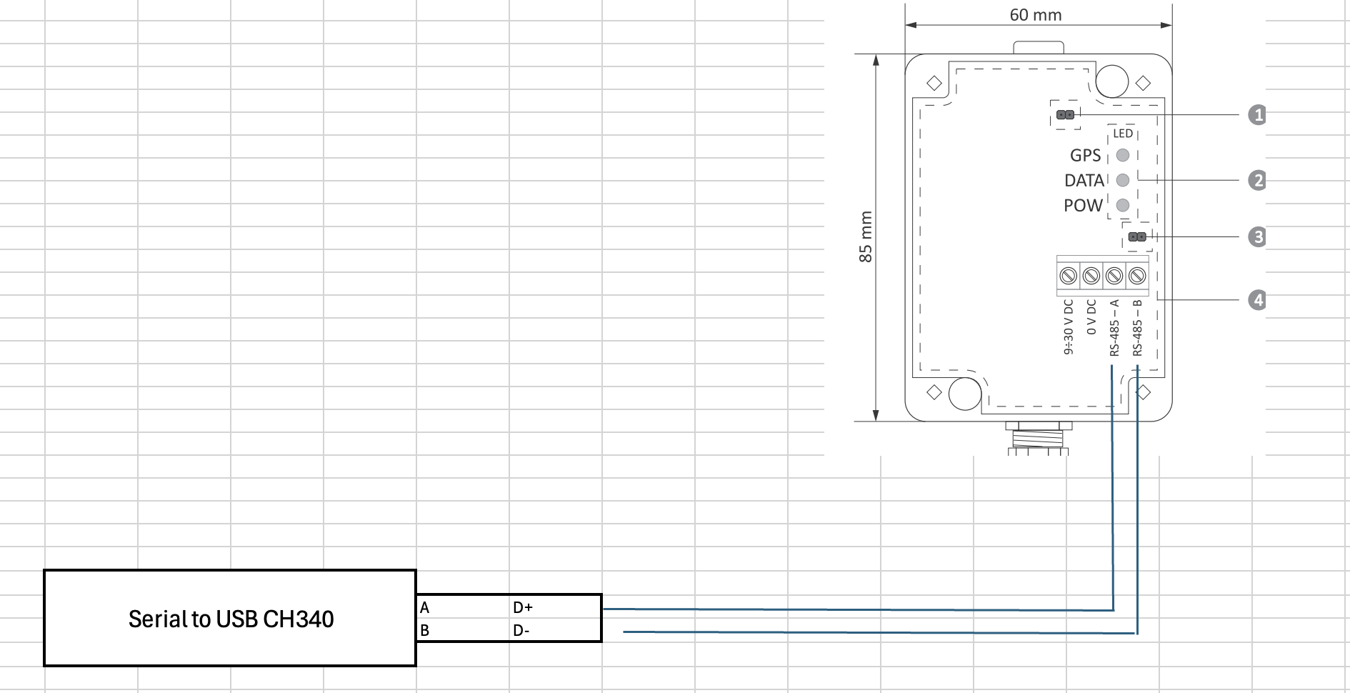

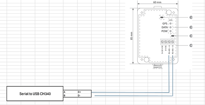

The strangest thing happens to me; I was asked to deliver a project showing the location of some assets while on operation in the field. Due to the fact that there are harsh environment conditions I have selected Arduino OPTA and F&F GPS Sensor MB-GPS-1 . Also I have 5 projects delivered with Arduino OPTA and the end user is using the dashboard and they like the IoT app. After a few fail attempts to read the sensor with Modbus examples I decided to make sure the sensor is working so I bough an Serial to USB convertor CH340 and used Modbus Poll to call sensor data and it worked well with the following specs:
  • Slave ID : 1
  • Baud Rate : 9600
  • 8 data bits
  • no pariry
  • 1 stop bit
And it is 100% working well.
However, when trying to get this data with OPTA and display it on a map on arduino dashboard I always fail.

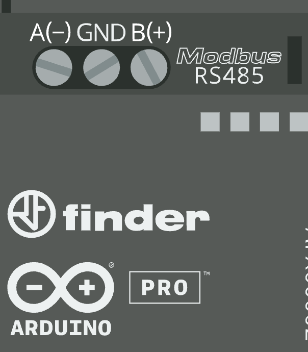

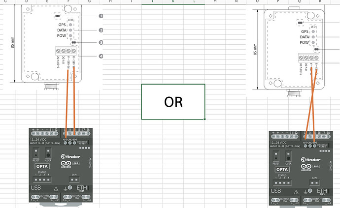

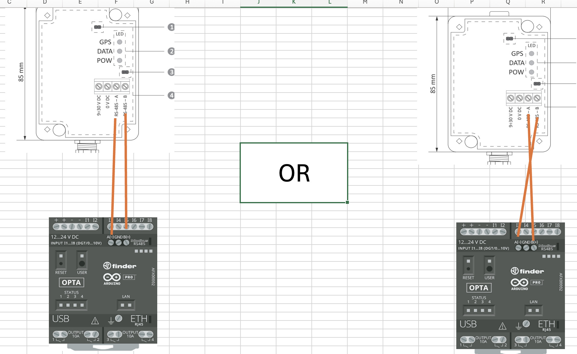

First question is around the physical wire connection. The working Modbus Poll case wiring was (100% working):
OPTA would be wired how?
And normally I would connect sensor A to OPTA A and Senor B to OPTA B but the fact that opta has A(-) and B(+) while CH340 adaptor has A (D+) and B(D-) makes me think how it is correct,
and Chap GPT suggest:

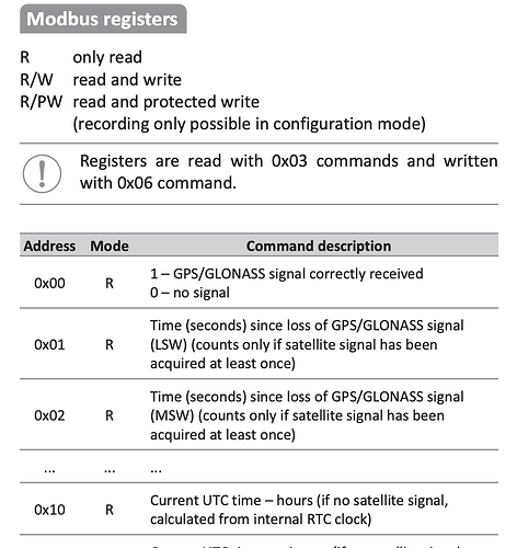

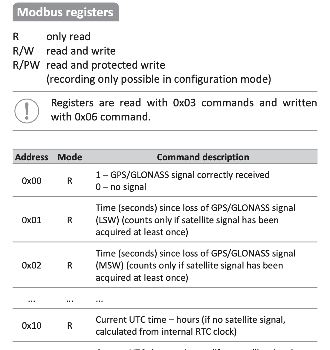

Plese note that I am trying to read register 0x00 with 03 command as per below snip from F&F manual:
Sorry for long post and thanks in advance for all your help!
