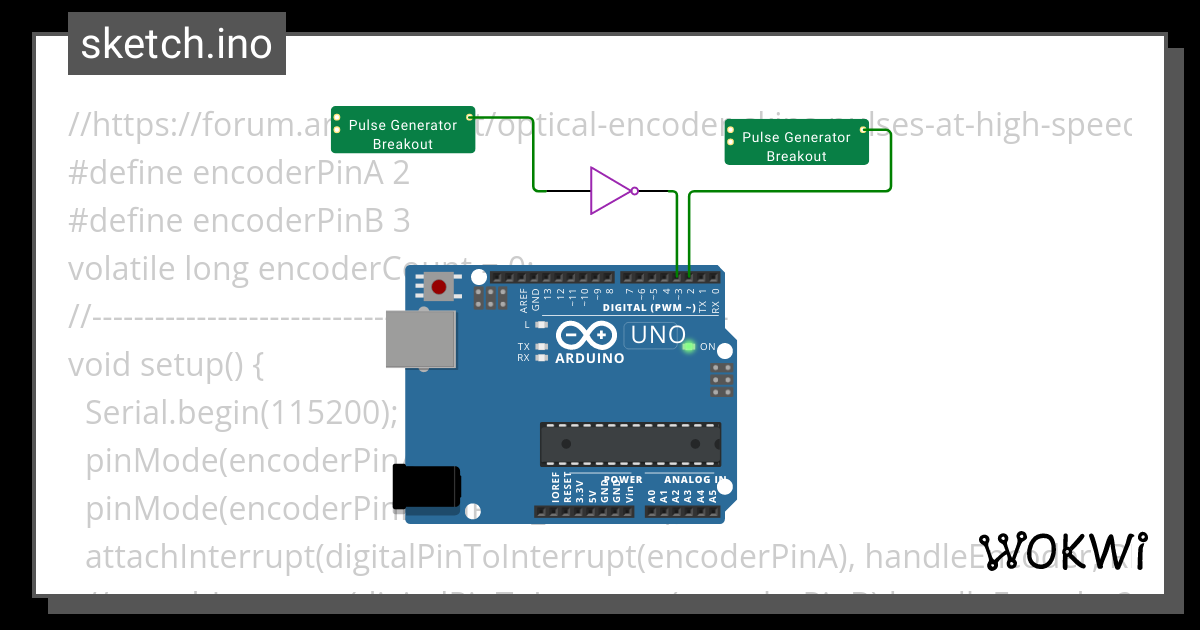

**Author:** ![ruilviana](https://dub1.discourse-cdn.com/arduino/user_avatar/forum.arduino.cc/ruilviana/32/722429_2.png) [@ruilviana](https://forum.arduino.cc/u/ruilviana)\
**Post date:** [June 25, 2024, 1:50pm UTC](https://forum.arduino.cc/t/optical-encoder-skips-pulses-at-high-speeds/1275203/9 "2024-06-25T13:50:23Z")
</div>
Try this code.
I changed the serial speed in the setup and the routine in the loop.
And I simulated it here using pulse generators to replace the encoder.
> **[OpticalEncoder - Wokwi ESP32, STM32, Arduino Simulator](https://wokwi.com/projects/401670083670203393)**
> Run IoT and embedded projects in your browser: ESP32, STM32, Arduino, Pi Pico, and more. No installation required!
```arduino
//https://forum.arduino.cc/t/optical-encoder-skips-pulses-at-high-speeds/1275203/1
#define encoderPinA 2
#define encoderPinB 3
volatile long encoderCount = 0;
  pinMode(encoderPinA, INPUT_PULLUP);
  pinMode(encoderPinB, INPUT_PULLUP);
  attachInterrupt(digitalPinToInterrupt(encoderPinA), handleEncoder, RISING);
  // attachInterrupt(digitalPinToInterrupt(encoderPinB),handleEncoder2, RISING);
  if ((encoderCount % 1000) == 0 ) {
    Serial.println(encoderCount);
void handleEncoder() {
  if (digitalRead(encoderPinA) > digitalRead(encoderPinB)) {
    encoderCount++;
  else {
    encoderCount--;
