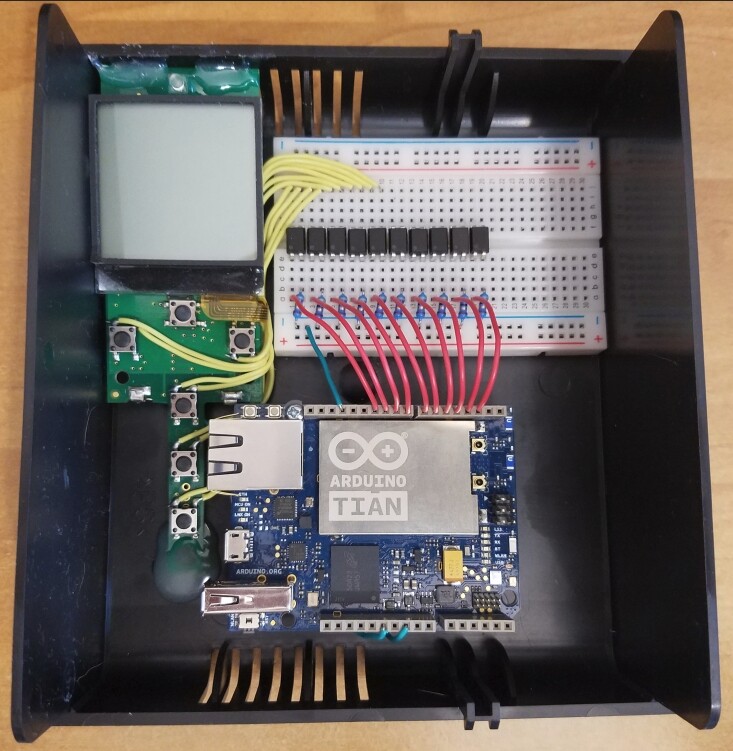

Behold! :smiley:
Nice looking tidy prototype, but when you get it all working, lose the proto board, that will give endless problems in a few months or less!
If not a PCB, solder it up with stripboard or similar. You won't regret it.
That white thing is afaik normally called solderless breadboard, not protoboard. Protoboard aka perfboard is soldered, and indeed the logical next step.
Also better to go for an Arduino Nano, and maybe some PC847s and a PC827 instead of ten PC817s.
