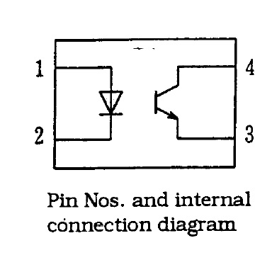

Can you draw a proper circuit diagram, showing your gnd and 3.3V, the ESP32 and the opto-coupler and how you have them connected together.
PLEASE do not use fritzy, draw it with pen/pencil and paper and send an image of it.
What do you want the input of the ESP32 to see when you apply power to the input side of the opto-coupler?
Please use this as your opto symbol.
![opto.jpg](https://europe1.discourse-cdn.com/arduino/original/4X/2/d/0/2d0160766bc65db87b127f3786448a1eb31f67a5.jpeg)
Do you have a DMM?
Thanks.. Tom... 🙂

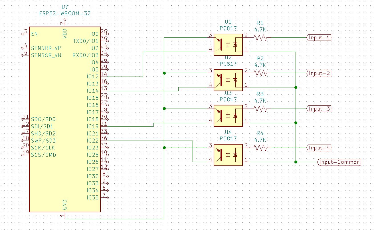

Sorry everyone for posting a confusing schematic. I've attached a better one this time.
> runaway\_pancake:
> The emitter/s should go to GND, the collector/s should go the input/s (INPUT\_PULLUP).
I see as per @runaway_pancake, I messed up where I should have connected them to GND, I used them on input pins.
> MarkT:
> If the 10k resistors are on the input side of the opto coupler, change to 4k7 if a 24V circiut and 1k if a
> 5V circuit, so there's a reasonable amount of current through the device, 5mA is a sensible minimum
> for most opto couplers, otherwise you'll get sluggish operation and very low output drive ability.
@MarkT, I did calculations earlier and it was supposed to be 4.7K, but when doing the test, I wasn't able to operate the OC. To be sure, I used a 20K Potentiometer, and the OC started conducting at 10K. I know this isn't a right approach, but the calculations didn't work for me.
Is this how this should be made? I have connected all Emmitter Pins to GND this time.
 ![KiCad-Circuit-Emmitter-to-GND.JPG](https://europe1.discourse-cdn.com/arduino/original/4X/6/c/5/6c518f55b465c827dcd2b61209bd6ceb7c06a1be.jpeg)

the optos are UPSIDE DOWN

> raschemmel:
Do you mean, emitters of the OC will be connected to Ground of ESP32 and the collectors will go to GPIO or the ESP board?
<div class="post-metadata">
**Author:** ![anon85221860](https://avatars.discourse-cdn.com/v4/letter/a/59ef9b/32.png) [@anon85221860](https://forum.arduino.cc/u/anon85221860)\
**Post date:** [October 16, 2020, 4:26pm UTC](https://forum.arduino.cc/t/optocouplers-giving-erratic-values/678413/17 "2020-10-16T16:26:55Z")
</div>
You have the opto inputs (pin 1,2) hooked up backwards.
Electronics is ~~a~~ detail-oriented.
PE - "Common" is ordinarily, in my experience, associated with "Ground".
One exception being a power supply with an output figured as Negative (which might be labelled NEG & COM, NEG & RTN, and so on).
I won't be back in, given all the QRM and QRN that creep in when people don't stay current with their subjects, but I thought this clarification important.
**Author:** ![raschemmel](https://dub1.discourse-cdn.com/arduino/user_avatar/forum.arduino.cc/raschemmel/32/241282_2.png) [@raschemmel](https://forum.arduino.cc/u/raschemmel)\
**Post date:** [October 16, 2020, 4:31pm UTC](https://forum.arduino.cc/t/optocouplers-giving-erratic-values/678413/18 "2020-10-16T16:31:24Z")
</div>
Yes
And you need 4.7k ohm pullup resistors on the collectors.
You need to reverse the connections on the led side of the optos.
You have the opto OUTputs (pin 3,4) hooked up backwards.
If you rotate the opto vertically 180 degrees , it will be correct (except for the missing pullups, which you can
fix with Input Pullup config in setup.)
