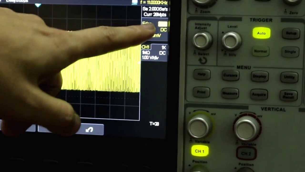

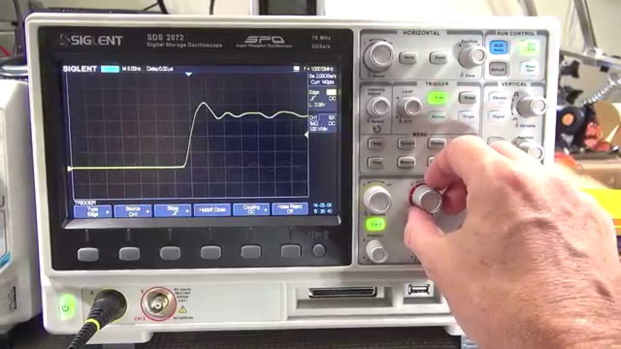

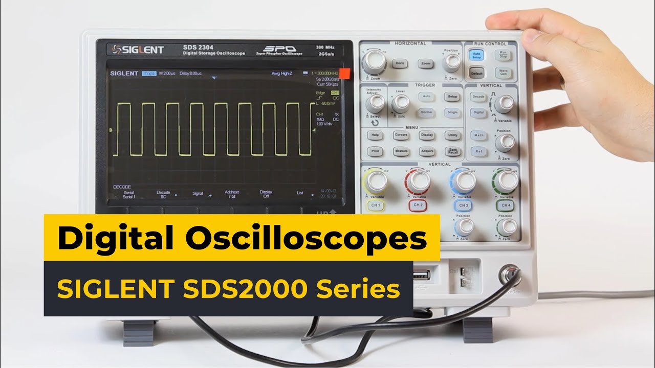

Please take some time and review some YouTube videos so you can make informed decisions.
Examples:

I will buy a salea logic analyzer and siglent SDS2102. I think 2 channel is enough for me(I can't afford SDS2104x-e. That is the real reason :yum:). I will not use this in a company, I will use it for my projects. SDS2000x series has a touch screen that is a nice feature. SDS2000x series have 10 times higher memory depth and 2 times higher samplng rate than SD1000x series. Also I watched a lot of videos about SDS2000, SDS1000 and rigol DS1054z. In conclusion I liked the SDS2000 series.
Well, just a hint as you wrote about the SDS2102. Without X or X-E.
Siglent is introducing a newer generation of scopes, which can be, to my knowledge easily identified by lowest vertical sensitivity. 1mV/div is the "old" one while 500”V/div is the newer one.
On siglent.eu you may notice that pervious generation is lowered in price and almost sold out. But, talking about a 2-channel 200MHz scope with 2GS/s the Siglent SDS2102X-E might be right choice - and even cheaper than the older SDS2102X.
And check also possible application of "16 Channel logic probe module" ... as it has been on your wish list.
So, double check, go for it ... and have fun!

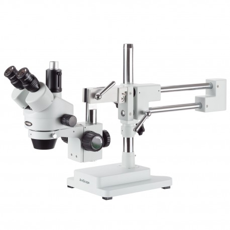

The next thing on your list should be a microscope, the most used tool next to the soldering iron on my bench. :wink:
Enjoy.
Thanks for the asnwer,
I will add it to my wishlist.
