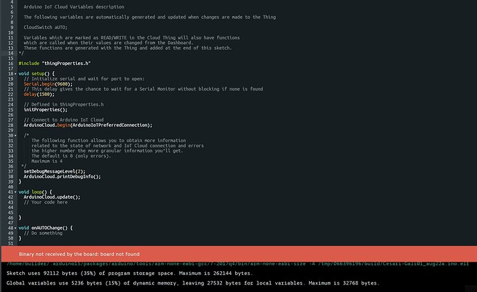

I am not able to update a sketch via the IoT cloud. The device is online, but each time I try to use OTA updating I get a "Binary not received by the board: board not found" error. The firmware is updated. I have tried three boards and all of them have the same problem. The sketch itself is just the boilerplate that is automatically created.
Hi, I'm facing the same problem. I have Arduino Nano 33 IoT, properly connected to the IoT Cloud. OTA updating worked fine one or two weeks ago and for all that time the dashboard communicates with the device (read and write) without any problems, even right now. However, today I'm unable to update a sketch via internet. All I see is:
Start Uploading sketch Test_jun23a Over-the-Air

I have a Nano IoT 33. Just got it set up. I can push the sketch to it via USB no problem. It does connect to wifi without issue. It does "phone home" and show "online" in the dashboard. It did upload OTA once or twice in the very beginning without issue, but for a couple days now it just says "Binary not received by the board: board not found" every single time I try to push the sketch via OTA.
I have tried what others in the thread have said which was to remove any "Delay" statements, which I have done and that made no difference.
I have even deleted the thing, and recreated from scratch and then pushing the default starting sketch first via USB, then once it was checking in, I then tried to push the same default/starting sketch via OTA. Same errors....
The board is checking in as it shows online and the last contact timestamp stays current. I can only surmise there is an issue with the cloud system?

Hi again,
new device, new thing with just a cloud switch variable and simple dashboard.
no modifications in the autogenerated sketch
OTA answered:
but device seems to bee online
