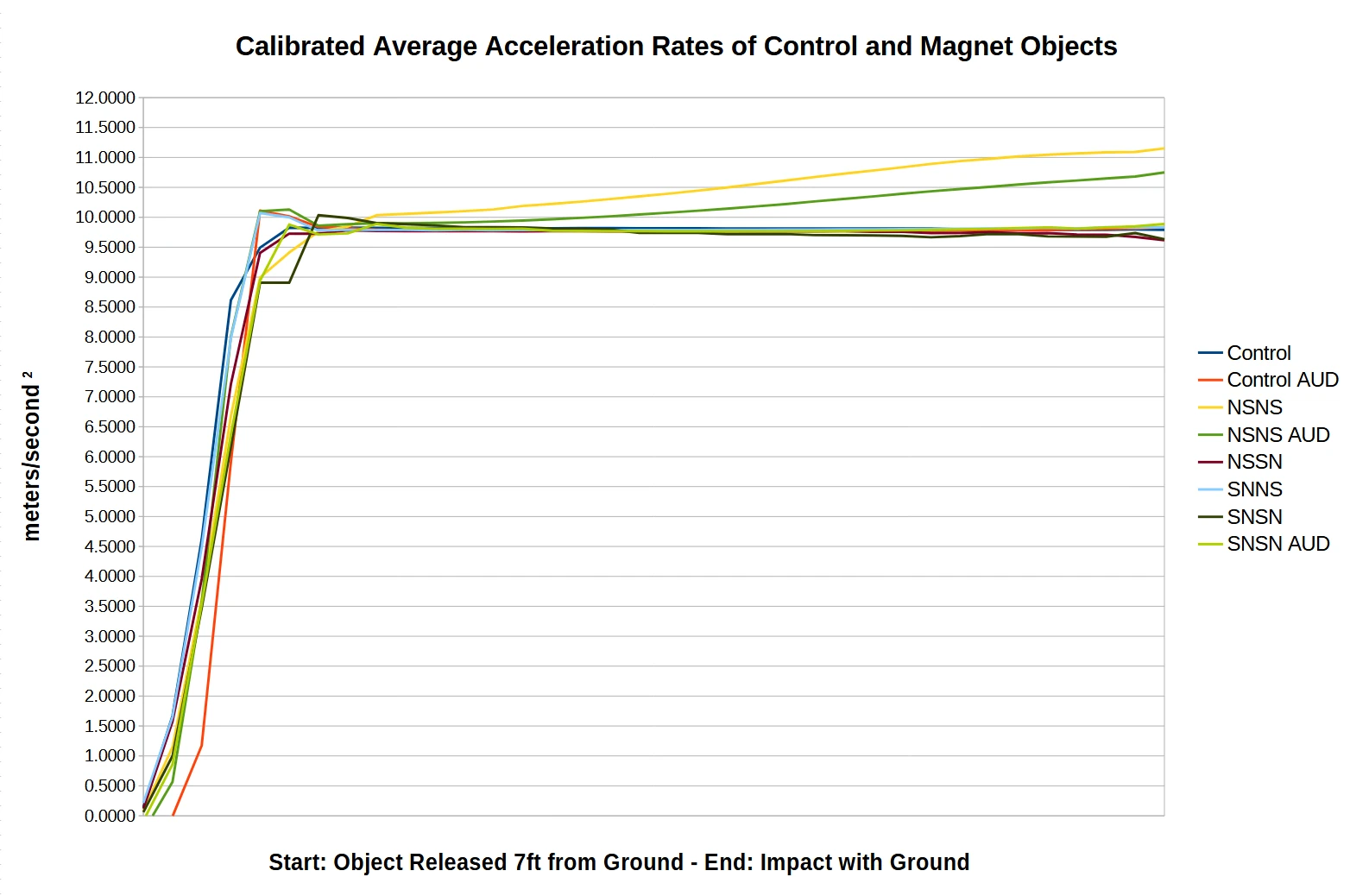

That agrees with my data on my Control, Control AUD (Arduino Upside Down), NSSN, SNNS, SNSN, SNSN AUD. When I converted the g-force to meters/second2 it was close to 9.8
For NSNS and NSNS AUD something more than normal free fall acceleration is occurring. My hunch is inertia reduction. I got the idea from Boyd Bushman a Lockheed Senior Scientist and the Brazillian team of Elio Porcelli and Victo Filho (who I got the idea to use an accelerometer from rather than a video camera).
You can look at my preliminary line chart that shows for the most part the acceleration rate is close to 9.8m/s2 except for NSNS and NSNS AUD where the acceleration rate steadily increases until the object collides with the ground.
I guess where I am unsure is if the z-axis starts out -1g then crosses over to (+) that means it is accelerating at a rate greater than gravity same as if I had the Arduino upside down and it starts out +1g then crosses over to (-) . That is my hunch but I was not certain.
My hunch is inertia is being reduced not gravity increased because I placed the NSNS, NSSN, SNNS, and SNSN magnet objects on a balance and they were almost exactly the same mass.
