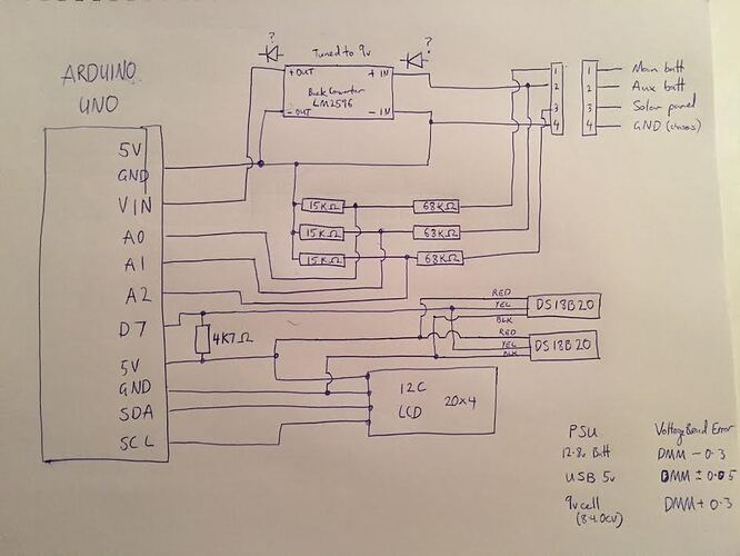

I've got an Arduino Uno V3 equivalent running a 20x4 I2C LCD, and am gradually building a vehicle monitor for my 4WD, starting with monitoring my two batteries and my solar panels, plus two DS18B20 temp sensors, before I move on to greater things on my Arduino Mega 2560 and KS0108B screen.

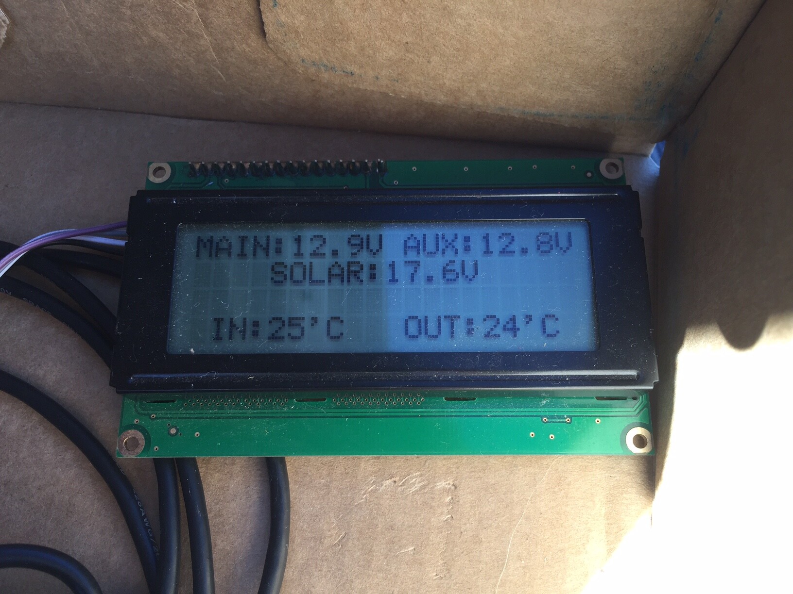

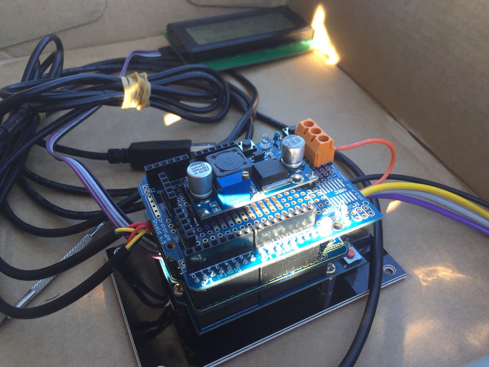

I've had these 2 years but in the past fortnight have really been getting in to wanting to finalise something and get it mounted in my car. Below is a schematic of my current circuit, and my code. I'm a Mechanical & Mechatronic Engineer, so covered much of this in my university education, but we never really got in to circuit design, and am coming a bit unstuck. I finally got a couple DC-DC buck converters (LM2596) to run off my car batteries, and I've got it running off my auxiliary battery (to avoid alternator and starter motor spikes), which should vary from 11.5 to 14.5v with the Buck outputting 9v. The trouble is, I'm finding that with the Buck converter, my voltages are down by approximately 3-4% compared to my Digital Multimeter, so the batteries show about 0.4v lower when the car is off. If I connect the USB cable for power and disconnect the Buck, the voltages are much more accurate, within about 0.5% of my DMM, which is fine with me. If I disconnect the car inputs but leave the USB and the Buck, the Buck converter seems to backfeed and show a battery voltage of 3.6V (which is why I've tentatively put Diodes on the positive lines of it in my schematic. If i disconnect the USB, and instead use a 9v cell battery (reading 8.4v OCV), with the car inputs connected, they are about 3-4% over what my DMM reads.
I've tried searching for similar experiences of others and haven't been able to find what I'm looking for. I found some code for checking Vcc and calculating based on that, so I've implemented that in my code, and it's a bit better than it was before, but still not right. I don't want the USB powering the unit, so trying to work out if it's a software or hardware issue. any advice would be so appreciated, hope I've covered all bases.
The code included the start of implementing a pushbutton and current measurement, but that's sidelined til I re-learn op amps. It's sort of been hacked together from a bunch of other examples, but I hope it's succinct enough. Thank you!
