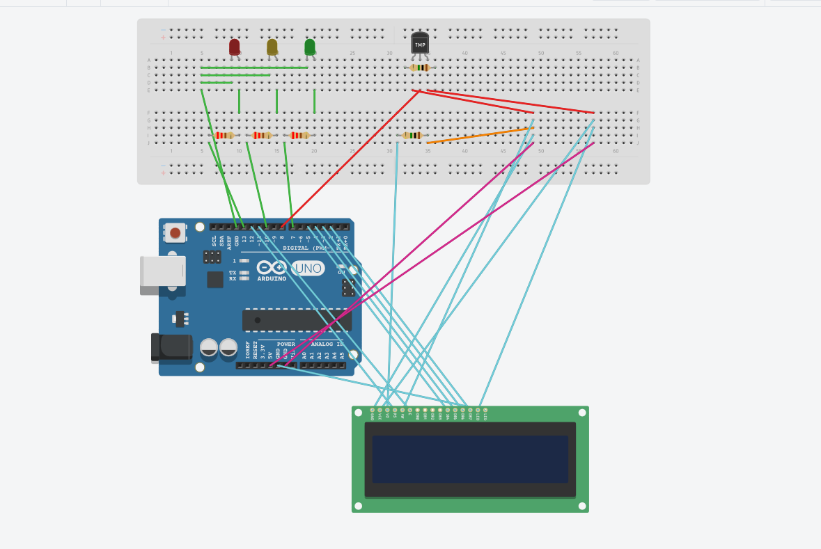

Hi Everyone !
So I am trying to make a DHT 11/22 project that displays the temp and humidity and has a corresponding led that blinks based on temp parameters. Although I have run into a major problem during simulation the current through back light is 23.7 kA while the max is 20.0mA. I built it and it fried my sensor can someone offer any advice. I have attached a pic of the circuit.

As soon as I see a Fritzy drawing I look away.
Sorry - but there are better ways to draw a schematic.
Pen & paper, Visio, Eagle CAD, AutoCAD
  • almost anything else than Fritzing,.
While the current did not get that high in real life, the simulation was telling you something useful.
Feeding a sensor, be it humidity or temperature, into a digital input is going to do nothing.
