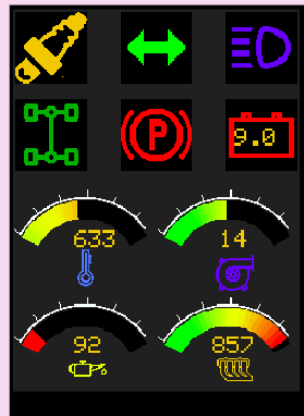

Overwriting tft print value change from 3 -> 2 digits
Hi All
I am trying to work out how to overwrite a value on a tft screen. The issue is that when the value changes from, say 123 to 63, it then displays 633. if I change the tft.print(value,0) to ( value,1) it displays better, but shows the dec point, which I dont want. I just want to display the whole number without dec point.
I could do a fillRect(x,y, backgroundcolor ) but would rather not as there is already a lot of things going on regarding screen display updates
Yes, the code is not completed and will get cleaned up when I get it to where I want.
Eventually it will run on a Teensy4.0, so speed is not a problem

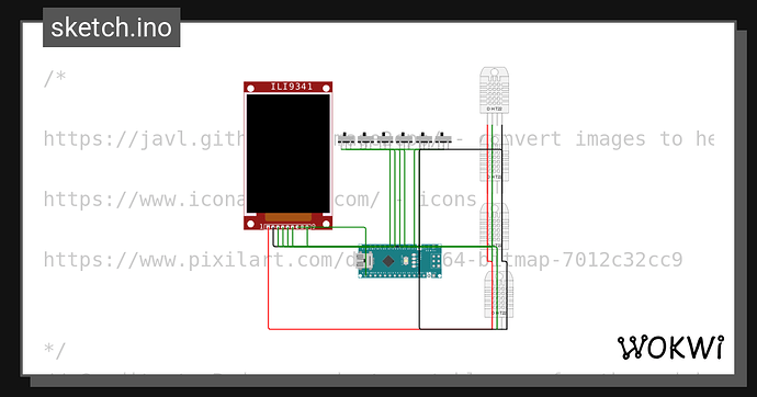

Below is a link to the virtual project -- first time using wokwi, and seems to work well
relevent code section here.

    tft.setCursor(185, 100);
    tft.setFont();
    tft.setTextColor(ORANGE, BLACK);
    tft.setTextSize(2);
    tft.println(Voltage, 1);
    //tft.setTextSize(1);
    tft.setTextColor(ORANGE, GREY);
    tft.setCursor(51, 185);
    tft.print(TempVal, 0);
    tft.setCursor(173, 185);
    tft.println(TurboVal, 0);
    tft.setCursor(51, 274);
    tft.println(OilVal, 0);
    tft.setCursor(167, 274);
    tft.println(ExhaustVal, 0);

You need to either clear the area before you update the text or use a string formatter like sprintf(buffer, ā€œ%03dā€, myValue); this will add leading zeros to your number. Make sure buffer is big enough for 4 characters because it also needs a terminating character at the end.
Typical method is to save the previous value, then when the value changes, display the previous value with the text color set to the background color, then display the new value with the text set to the desired text color.
Generally better to only update the value on the display when it changes, constantly rewriting the same value can cause flicker, and slows down the code.
Using the default font in the Adafruit GFX library, with the background color specified in the setFontColor() function, you should be able to use leading spaces. This will only work with the default font, the background color is ignored on all other fonts.
The Adafruit_GFX library also inherits from the Print library so if you use setCursor(x,y) and the printf("%3d", value); Assuming you can use printf that is...
Otherwise just clearing that section before you update the text would be the better approach.

        myGLCD.printNumI(vspeed, speed_x + 96, speed_y, 2, '0');
        // Print the 3 digit speed
        myGLCD.setColor(text_colour1);
        myGLCD.printNumI(vspeed, speed_x, speed_y, 3, '0');
You could even throw in a
if (vspeed != last_vspeed )
around the whole thing to further reduce time wasted drawing to LCD, but I seem to remember in my case the loop time and update rate wasnt affected too much anyway.
I think this is mostly what others have been saying, hope it helps.

so as long if your font isn't proportionally-spaced, no issues are expected (even when it is, it may still do the trick for you)
In that case you could just print a space before the value if it is smaller than 100, but in some ways a filled rectangle makes just as much sense, since in the end, that is what printing a space is.
On second thought, you could also add a leading '0' but that might not be the look you want.
Of course....then you just format the string
I think that could work....
You did not post all the code so I presume "value" is float
Change value from float to int.
The try the first method I suggested. When you print a value, save that value to a variable. Whenever you want to print a new value, first print the old value with the text color set to the background color, and second print the new value with the desired text color. Printing the old value in the background color erases that value from the display, and is a bit quicker than writing an entire rectangular area.
Having the previous value saved in a variable also lets you compare with the new value, and only print to the display when the value has changed.
I did post the full code
Ok sorry found it.
Yes, a print only if value changes is a good option, considering that the values in real life change very slowly....I was also looking at doing an average for each value, which slows down the refresh rate, but wont help the initial problem.
Ultimately, I am asking for the impossible. But it is good to share ideas
