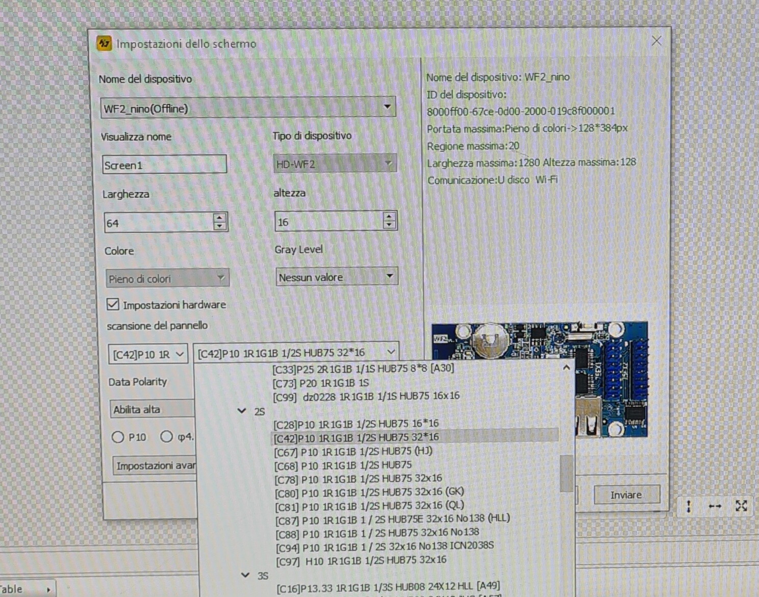

Good evening everyone, I bought 4 P10 RGB matrix displays marked:
P10(3535)1632-2S-M3 they are 1/2 scan and I can't find anything to make them work, can someone
help me wire and make these displays work?
I tried the HD WF2 board, for now it is the only solution that can make these panels work, using the HD2020 program set with the C42 panel as shown in the attached photo.
My question was if I can make them work with an ESP32 or ESP8266 board or Arduino Mega.
I hope someone answers
 ![HD WF2](https://europe1.discourse-cdn.com/arduino/original/4X/7/5/1/75161d07c9e955fd537aad1cb944eb09a6767f09.jpeg))

Most of Arduino libraries for HUB75 panels are not compatible with 1/2 scan.
You could try with my [DMD\_STM32](https://github.com/board707/DMD_STM32) library , but it works with STM32 and RP2040 boards.

> [@nino\_65](#):
> Quali pannelli RGB P10 posso comprare per avere una compatibilità totale, quelli con scansione 1/4 - 1/8 ?
To be sure of compatibility, you need to know not only the scans, but also the IC installed on the panel.
But in general, it is preferable to use panels whose scan is equal to half the height - that is, if the panel is 32x16, then it should be scan 1/8, if 64x32, then 1/16 and so on

[https://github.com/pixelmatix/SmartMatrix](https://github.com/pixelmatix/SmartMatrix)
Use this lib and try Example -\> multiple layer
\*Use kPanelType as below
const uint8\_t kPanelType = SM\_PANELTYPE\_HUB75\_16ROW\_32COL\_MOD2SCAN;
