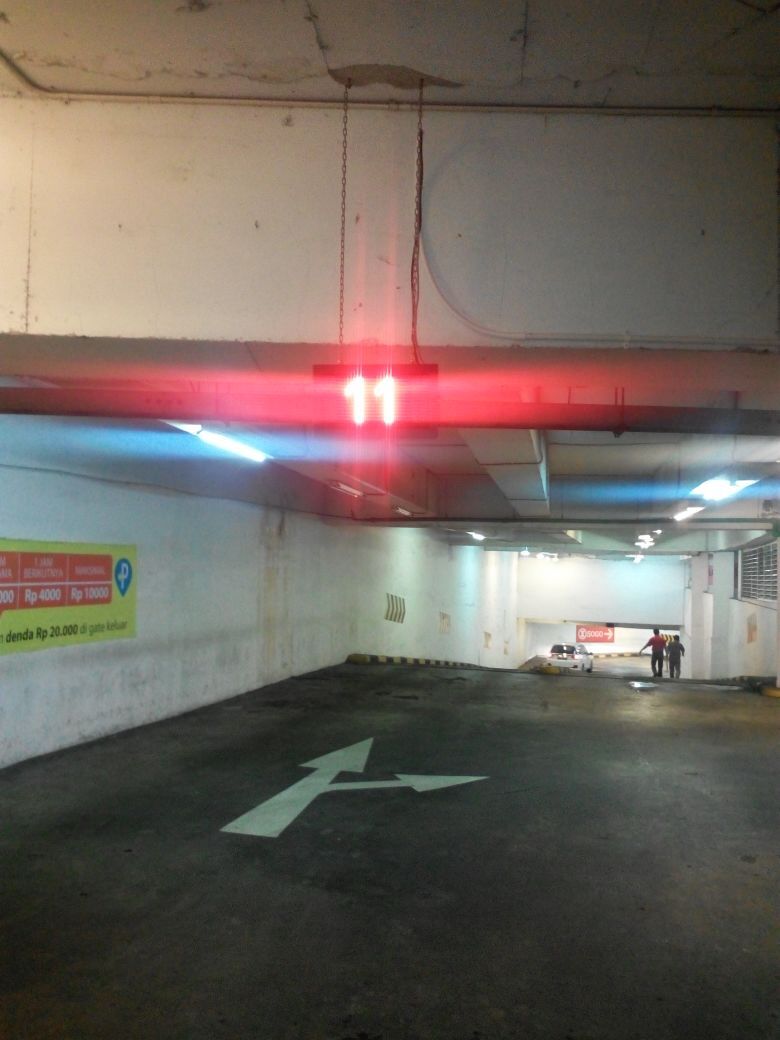

Hi, for a large project for a 100 slot parking supervision system there need to be 14 7-segment/2 digit 7" display panels each showing different values (ie free slots for specific and different parking segments).
The hardware supervises sensors (1 per parking slot) giving real-time either "vacant" or "occupied" status for each slot to the control system.
The parking consists of 2 underground floors of 60x40m size. The panels will be situated on distances of >100m from the controlling pc.
What I look for is a solution that allows my programmer to address each panel individually and transmit a specific 2-digit number to each panel.
I know there are drivers for 7-segment displays but I need to have a solution to address these display panels individually. Similar to large highway display panels showing the price for different fuels at the next petrol station.
My programmer uses C++, the software will be installed on a W10 pc, but the information needs to get out of this pc to the display panels and their individual drivers.
The controller W10 pc is situated about 50m from the actual parkings. The addressing of the individual display panels can go over TCP/IP.
Question: How would this on hardware level best be accomplished, with what best solution for hardware drivers?

Our supplier today has sourced tcp/ip driven displays with text possibilites; USD175 FOB (see photo), but worth the cost since the whole project is budgetted at USD35.000
