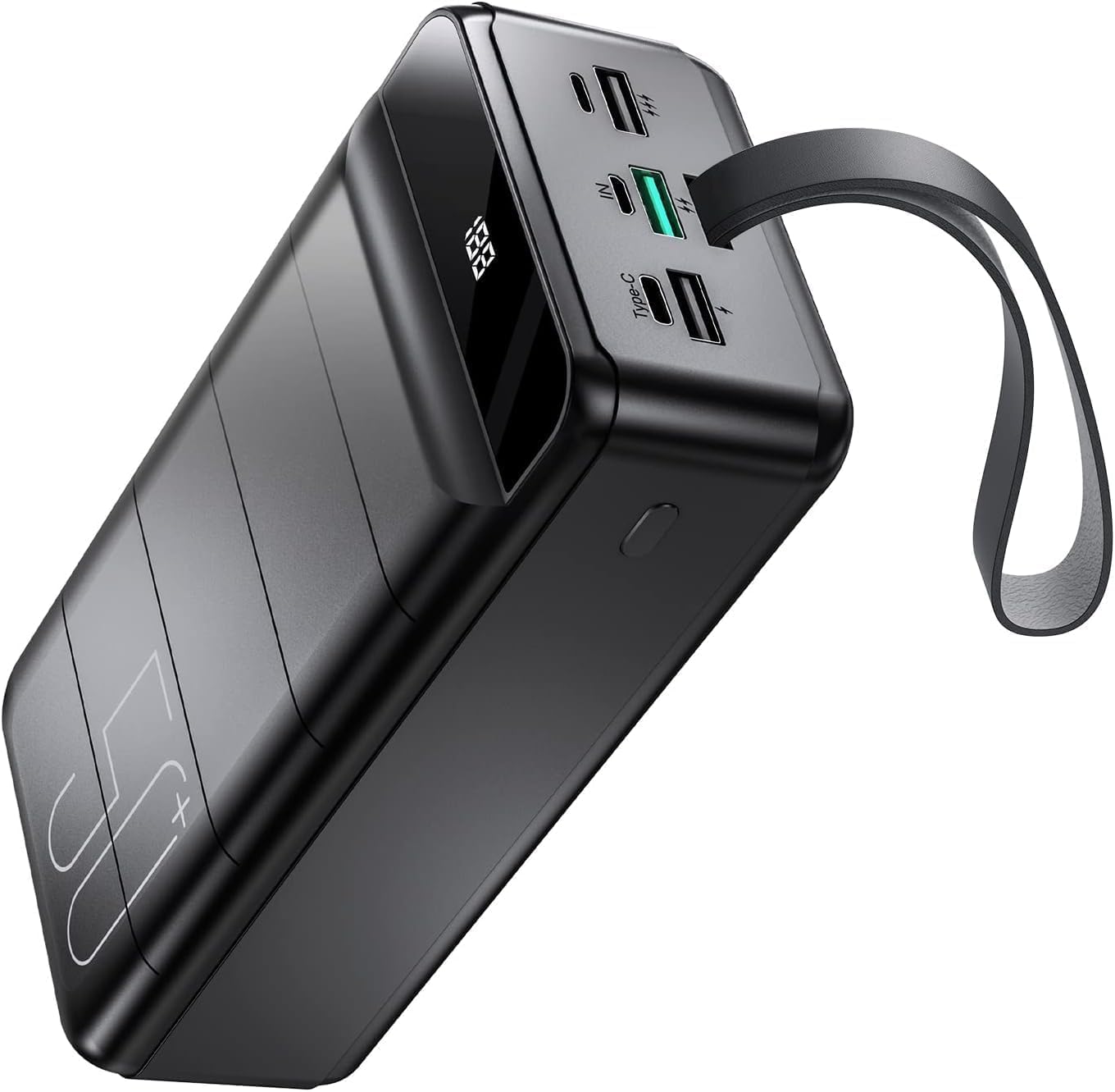

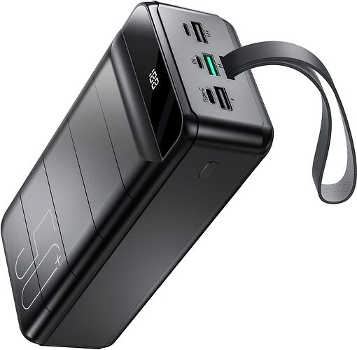

I figured settling for a 50,000 mAh power bank was sufficient, but let me know if it poses problems.
The power bank I was looking at provides 50,000 mAh. At 5V it provides a current of 3A and at 9V it provides a current of 2A. It can go up to 12 V, but I doubt it will go that high.
I was looking at this one:

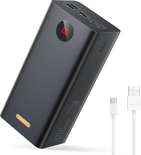

If 50,000 mAh isn't suffecient, I did find this 60,000 mAh. I bit pricey, but I figured the mAh was just the amount of mAh capacity it could store for a certain time.
This 60,000 mAh has a 5V at 3A and at 12V it provides 1.5 A.
