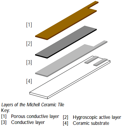

There is a big difference. The size of a gas molecule or water vapour molecule is very small, and they are very mobile, so they can enter a sensor through a small hole with no assistance.
A PM sensor needs a fan to draw the gas (or liquid) through. Then you can catch the pm in a filter and weigh it; or - as this unit does - use light scattering from the particles.
To get useful results you need a good airflow and a "large" chamber with external light excluded.
Perhaps this approach would give a smaller sensor - but you still need the fan and a good airflow
