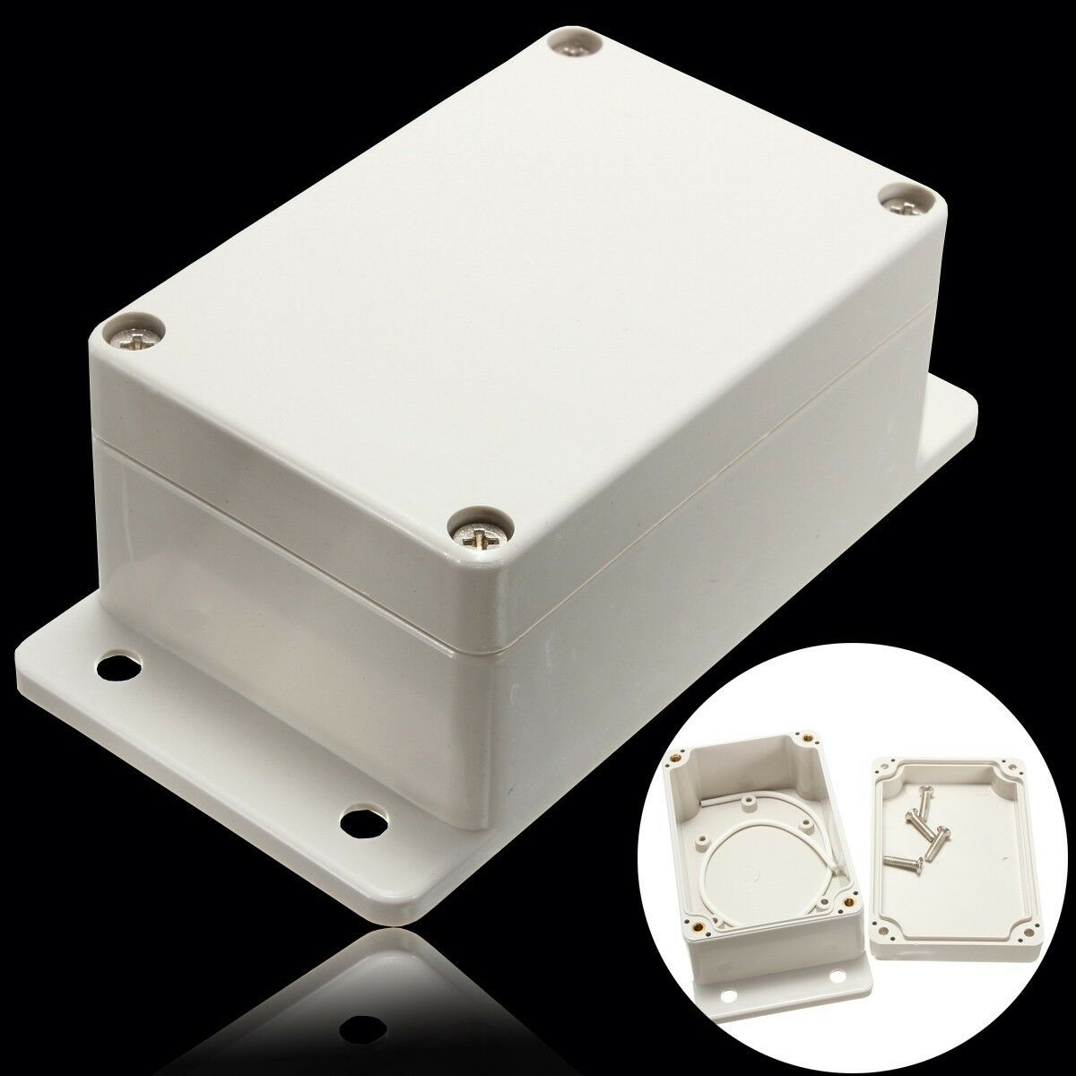

You can buy nice waterproof plastic enclosures on eBay and Aliexpress in a variety of sizes for a good price:
But you should be able to get that sort of thing from most electronics component distributors and electrical supply stores.
Well, your post got me thinking along the lines I should have thought in the first place. I can search for waterproof enclosures and see what I find. That ESP32 looks good. Now I need to make my parts list, decided how to mount in the box, and determine what I need.
