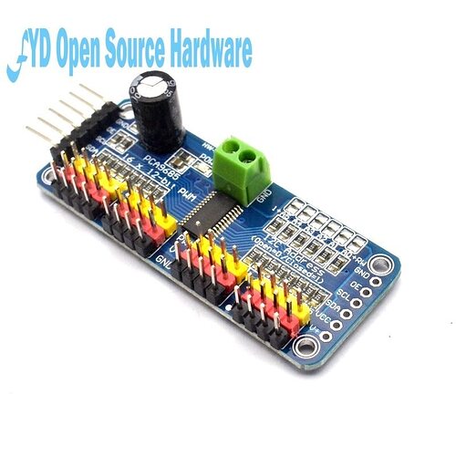

PCA9685 16 Channel 12-bit PWM Servo motor Driver
Does this look feasible as the makings of a haptic vest to be controlled over I2C?
If it does, I wonder if somebody would be prepared to suggest what I might need in terms of a circuit for each motor. I gather I’d need 3 wires on each and that somewhere inline there would need to be a MOSFET (+5V>Collector, PWM>Base, Emitter>Motor>GND) and probably also a diode? If that’s correct, could anyone tell me what parts to use and in what configuration? Wire run might vary from 10cm to 120cm and it would be much easier construction-wise if the transistor could be at the motor-end, would this be a problem?
I feel pretty confident about the software challenge but I just don’t know if the electrical side stacks up. Anyone?
OK, a couple of problems here.
While you refer to the motors as 150 or 200 mA - I don’t know where you got those figures as I could not find the specifications in the Aliexpress link - that is probably the “no load” figure and they may require up to one Amp each to start. So the PCA9695 module could not drive then directly; you would require logic level FETs to actually drive the motors.
Do you actually expect to speed control the motors?

The PCA9685 control outputs are in triplets (V+, PWM, GND) , presumably ground is common. Would I need to bridge grounds on this board?

“Gnd” connects to the Arduino ground, not necessarily the same as the motor supply. If using a common supply, you need to wire the motor negative - with all the motor wiring always bundled together - directly to the power supply and the Arduino 5 V and ground - also bundled together - directly to the power supply .

That is correct. You should not use the PCA9685 module to distribute the power for the motors, so the motor ground should only connect to the FET module. Your black and yellow wires go together, only from the right hand side of the board in the diagram, to the pins on the PCA9685 module which is set up specifically to drive small servos which have that three pin connector.

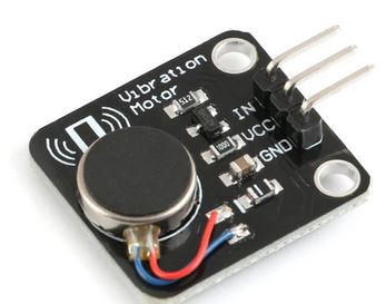

Hello everyone! this is great to find that me and @ionman are basically working in parallel on a similar idea. i just want to mention to ionman that i have gone through a different route while using the PCA9685. I instead am going to use the " PWM Vibration Motor Module" which does give me the motor, mosfet and the pwm signal IN in one cheap package. why not use them @ionman ? simplify everything. by the way that vest seems overkill too, maybe it needs to be lighter, thinner and maybe tighter?
motor
by the way i would need your help in the software part, do you think you can help me too? i am gonna use an Arduino for controlling the PCA9685. I look forward to everyone help here too.

That’s an interesting module with lots of advantages in terms of connectivity and power use. But I would expect it’s incapable of representing heavier ‘touches’ like being hit or the recoil through a rifle stock - obviously even the motors I’m planning to use are actually inadequate, but closer to what’s required.
I could certainly see a hybrid design or these vibrators incorporated on an inner array (maybe via a second, daisy-chained PCA9685) to signal lighter contacts. The parts are so cheap compared to buying a ready-made vest there’s plenty of scope for doing something more elaborate.

How do you know it is a FET?
I see, you have many points indeed but for me those small motors would be just enough. I am not trying to stimulate multiple punchs on the user after all :laughing:
My work is mostly away from gaming and I do it as a form of a non profit art installation hoping for quest. I thought of Bluetooth for comms instead wifi. Since the module is cheaper for Arduino. By the way I am within the central Europe. Since you asked my location.
Hi @Paul_B it is a FET. I zoomed on the image and the code is A2SHB which is a small package mosfet. You can Google it to find it’s data sheet.
