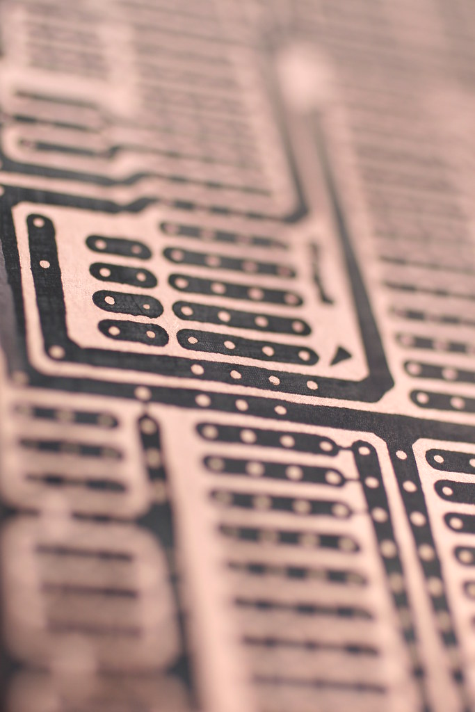

Glad you hear that you've got the connector sorted out! Do let us know how you get on with the PCB etching, too. I've done three boards now using Toner Transfer, all of them for AVR chips and all successful. Photos here:
Hi Anachrocomputer, that's very impressive! What paper did you use?
Thanks, mem! I used junk-mail paper! It was thin, flimsy and cheap, but glossy. It's the glossy coating that matters, because that's left behind, stuck to the copper by the toner. The thin paper washes off very easily and the toner sticks to the board much more strongly that I expected.

I'm a little anxious about the etching to be honest; it's a very simple circuit, but either requires a two-sided board or fairly delicate traces going between adjacent holes, etc. I'm pretty nervous about trying a two-sided board as my first etch, not to mention traces would have to be REALLY fine to make it between holes. I curse the max233, which seems to want some pins wired to each other but requires traces to cross (at least it looks that way to me). Here's an early draft of the single-sided board:
... it's what Eagle did with autorouting after I got frustrated and gave up.
Am I being unduly frightened away by two-sided boards? Looking at my blobby soldering of my protoboard with the IC, I'm not sure I can keep traces between solder points clean.
I don't think eagle has done you any favours. I think you can get a much simpler single side board if you do some manual routing and perhaps add one or two jumpers. If you can post the eagle files somewhere, you may even get one of the eagle experts here to give you a hand.
Yeah, probably true--and admittedly, this is my first ever use of Eagle, Arduino, etc (nothing like digging in to serial and USB comm on a first project, I guess). So I'm sure I'm making lots of simple mistakes. There are a couple more mods to the board I'm planning on (a line between pin 1 and ttl in on the max233, and microswitches on pin 0 and 1 so I can turn off the external serial port when reprogramming) but basically it's that. I'll play with it and put up a "aaaugh, help me!" in a day or so.

Home etched double sided boards are doable. I don't bother with complex designs that require toner transfer on both sides; it looks like too much work to get them aligned. Here's what I do:
  • lay out the board with maximum traces on one side. if I have PTH and SMT parts, I end up with PTH on one side and SMT on the other.
  • put no vias on IC pins, since you won't have PTH
  • arrange vias so that any traces on the other side are straight and, if possible, make them all parallel (or perpendicular, if you can't manage that). The idea is simplicity - you'll draw these by hand later.
  • make the via pads a bit larger than default, to make life easier for yourself later
  • do toner transfer as usual for the complex side
  • drill holes through vias as small as possible (I used the uselessly small bits in the Harbor Freight set I bought)
  • using the holes as endpoints and a straightedge, connect the dots on the simple side of your board, and draw a pad for the via. (I used the PCB marking pens and didn't like them; I prefer paint pens). I also put a paint dot on the complex side of the board to prevent the etchant from attacking the copper edge exposed by the drill.
  • etch the board (I like HCl + H2O2 much better than FeCl)
  • clean as usual. I usually end up using acetone for the toner and naptha for the paint.
  • solder "Z-wires" into the via holes. I use a drill for the "connect the dots" stage so small that I must redrill the holes. I use discarded component leads (resistors, caps, etc) that tend to be lying on the bench, in the floor, even after I clean up...
Take a look at the single sided arduino serial version 2 board layout, if it's still around. IIRC, it has about 4 traces on the top side, and they're all straight lines. Look at this board after reading my babbling and maybe it will make sense.
-j
No, that makes sense (and the single-sided serialduino made me say "oh, that works much better" with the idea of jumpers on the top surface). Having seen that, your explanation of "toner the bottom, manually draw the top" works very well--although mine is so simple that I can probably just jigger the design a little bit and do it with a soldered jumper rather than doing proper vias, at least on the first go. Thanks for the idea, though--makes good sense.

I think you'll need much wider traces if you're going to do this with Toner Transfer. My thinnest traces were about 15mil (15 thousandths of an inch), and they were tricky. There's no penalty to making the traces much, much wider, and it'll make the TT easier.
As for the routing, I used the GNU PCB program and it "just worked", although I did all the routing by eye. Then, I printed out a 600dpi version on the laser printer (HP LaserJet 4+).
The traces can be thick; the gaps need to be narrow. You can always cut away extra copper using tools ranging from knives to dremel tools, but putting back more copper is harder. I'm a big fan of wide traces, and wrote some suggestions on modifying design rules for hobbyist fabrication here: http://www.instructables.com/id/Make-hobbyist-PCBs-with-professional-CAD-tools-by-/
