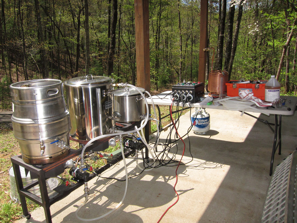

No, far less. The whole contraption is only 5 feet long. The application is a three vessel brewery, like these:
https://www.google.com/search?q=brutus+10&um=1&ie=UTF-8&hl=en&tbm=isch&source=og&sa=N&tab=wi&ei=O_u3UaOcK4TU9gTA1IGAAw&biw=2560&bih=1509&sei=vfu3Uf-3PIXy9gSas4G4Cg
These are commonly built with a large control panel built on a huge NEMA enclosure. There is usually a 220 feed, controlled by PIDs and relays, and then numerous 220 lines go to various parts of the brewery. See Gallery - The Electric Brewery to get an idea of what I mean.
Here's the scene I want to avoid: http://www.beerobsession.com/wp-content/uploads/2011/04/IMG_0695_rdy.jpg
My intent is to minimize the 220 wiring by having a din rail run basically the length of the brewery, and having the SSR's as close to the elements, valves and pumps as possible. I'd have an I2C slave board for each component, so I'd really only need four wires for all of the controls. These phase angle controllers are going to be three of those slaves.
So, I guess have options:
  1. draw an I2C slave for the pumps with the microcontroller, the 220 relays, all of it, and mount it right on the pump bracket.
  2. draw a board for just the 220 parts - the mechanical relay, the SSRS, and the H11A1, and send the zero-crossing signal back to an I2C slave on the DIN rail (~9 inches away from the AC pump motors).
  3. draw a board for just the 220 parts - the mechanical relay, the SSRS, and the H11A1, and send the zero-crossing signal back to the control panel itself (2-5 feet from the pump motors).
