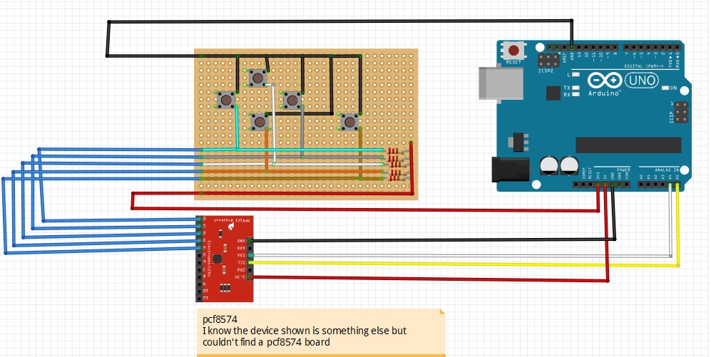

I am using a pcf8574 board from waveshare to give me 5 key inputs via i2c.
I wired up initially without pullup resistors and was getting intermittent indications of key press and wrong values , so, I stuck in some 10k resistors and provided 3.5 volts to the circuit. I was still getting odd indications so I thought maybe 5v.
It seemed to be ok for a good while and then I was getting odd key presses again, if I turn power off and wait for 10 min and then turn it all back on its good again, until its not.
So I suspect that I have not got the correct resistors or ......

expected serial output of pressing keys in order of 0123401234
Opening port
Port open
TESTPCF8574
0123401234
BUT occasionally I get random key presses the can start and then just continue
01234012340000000000000000000000000000000000000000 ...
0 with no key pressed
sometimes pressing 3 will illicit a 0 in the output
turn off the device wait 10 minutes turn it back on and its working ok again
