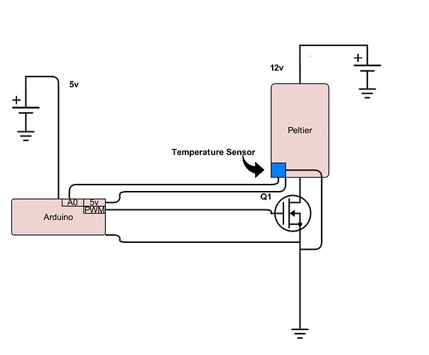

TomGeorge:
If you are controlling a MOSFET gate with the UNO or any controller, you must have the gnds of the controller connected to the gnd of the load supply, so that you apply the correct bias to the MOSFET gate.
Use you DMM and measure if there is any voltage between the UNO gnd and the MOSFET source pin, please.
Tom.. :slight_smile:

I apologize, I haven't had much time to focus on this much so i took some shortcuts.
I dont know if this is detailed enough for yall or not but heres the basic circuit I am trying to build.
Useless diagram.
Find a hobby that you have time for.
Maybe this is better
This might be better;
Tom... :slight_smile:

Thank you.
Finally got the mosfets in, now working on writing the code.
What I have now compiles correctly and shows no errors, just wanted to check with yall to see if there is anything I should change.
Here's what I have:

ok, so ive built the circuit with the mosfet and trying to run with the code above, but the mosfet is staying on. Here is the link to the mosfet I am using: N-MOSFET Driver / Output Module | Freetronics. any suggestions?
Have you got it connected correctly?
Have you got valid temperature readings on the lcd?
 float getVoltage(int pin);
What is the pin number for "int pin" and what is that line supposed to do?
TomGeorge:
TomGeorge:
Yes, I have it connected as shown in the diagram, but the mosfet will not turn off. That line of code is for the inside temp sensor.
Also, I dont have the lcd hooked up, but i'm printing them in serial so I can see the temps.
Ok, so i have it running now and the desire temperature is being reached, however I dont think it is due to the pwm control. The serial monitor is printing the power percent and it is staying around 30% but when I measure the current output of the power supply and the current input of the peltier it is running at the normal amount for 12 volts. I think this piece of code may be an issue :
  if (loopNum == 20000) {
    degreesC1 = dewpointtemp / 20000;
    dewpointtemp = 0;
My dewpoint will never be 0, so this is incorrect. Not sure how to correct it though.
