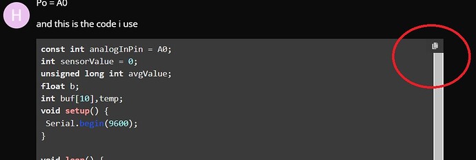

Try this code, there is a for statement that didn't look right.

If you move you mouse up to the top right hand corner of the code window you will see a "copy" icon appear, left click and that will copy it , then paste it into the IDE.
See if that runs.
Can you please post an image of your code please, so we can see your component layout.
