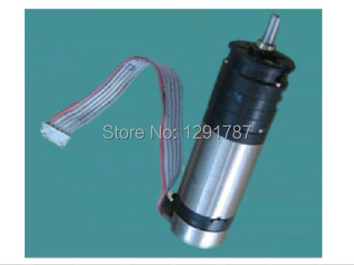

i am working for the making of PID with DC motor with encoder, i have tried so many ways, and in all of them i have failed, i havebeen looking in other post but they usually do different things and that confuses me more i gues maybe the problem is the setpoint variable, because the program works good until the readin of the encoder or maybe the way i put te output. i have used this gear motor http://g01.a.alicdn.com/kf/HTB1aiI.HVXXXXc1XXXXq6xXFXXXe/ESCAP-16-Coreless-DC-12V-540RPM-font-b-Gear-b-font-font-b-Motor-b-font.jpg and the arduino uno. If you ca help i will be so happy because i have spend so many hours in this without much progress. Thnaks for your attention

jeje sorry for been to general, well the motor is going to be moving the link of a Scara robot, and i want that this arm moves fast when it´s far of the desired position, slowing while it approaches to this place, the thing that is bothering me in the program is that while i am reading the serial of the encoder it does not stop incrementing or decreasing, even if i change the setpoint, and with that i do not have PID, just a motor that is always acive. if i am able to fix this i will read a vector from matlab to change the setpoint and control this little arm. Once again sorry for not saying that in the first lines, i have not sleep for an entire day and i am kind of distracted
