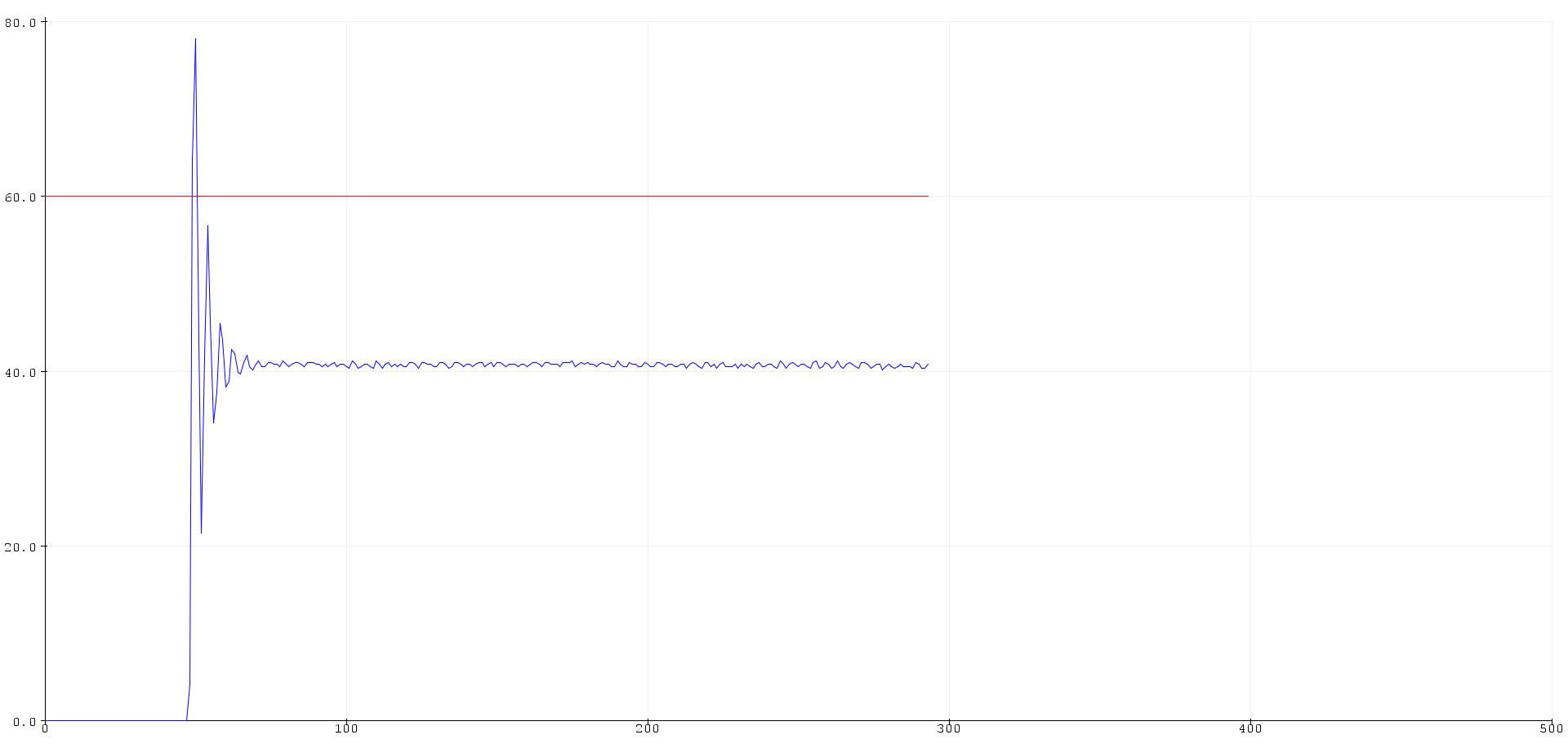

So I was trying to tune the PID control for my DC motor (set to the desired speed and get to that speed) but I didn't really get the response I want.
For these parameters: Kp = 10/3, Ki = 290/300, Kd = 10/300; this is the response I got.
Imgur
It does not really get to the set point and there's a fair bit of overshoot.

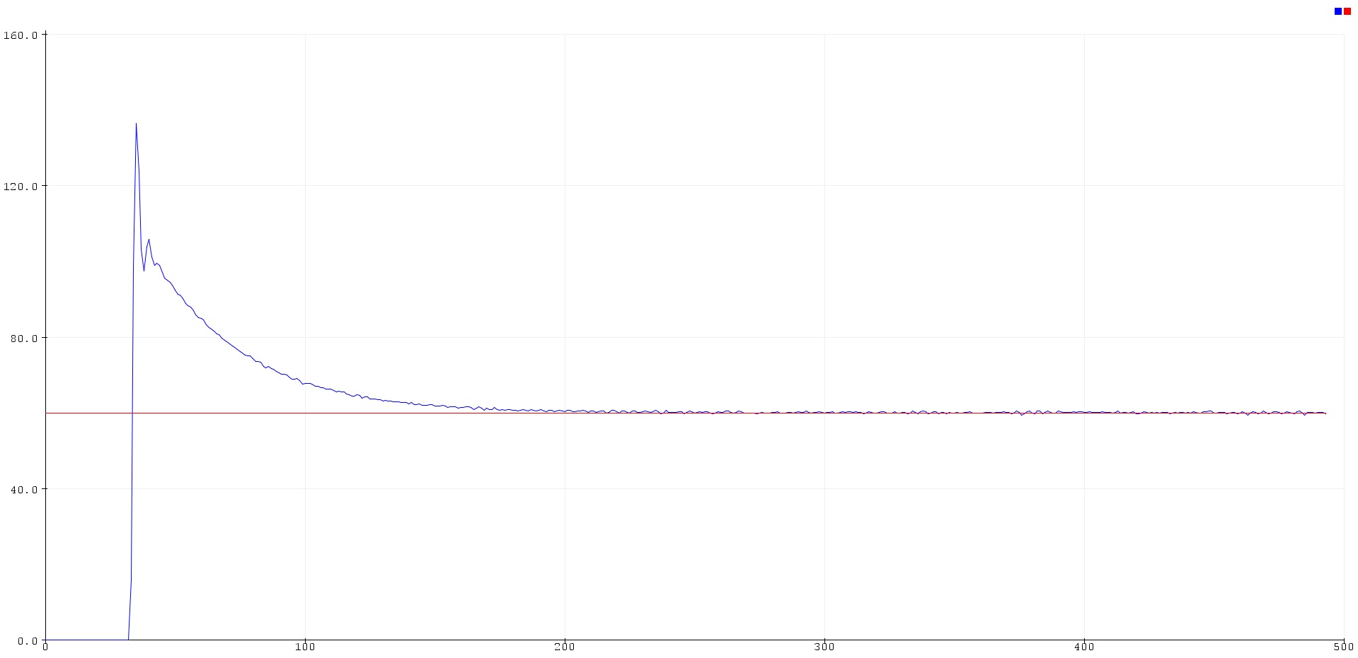

For these parameters: Kp = 10/3, Ki = 300/300, Kd = 10/300; this is the response I got.
Imgur
This time, it overshoots the setpoint and takes forever to go back.
I'm looking for somewhat less overshoot and actually reach the setpoint. The response time can be NOT instant to accommodate these requirements.
Any ideas how should I go about finding the correct parameters?

There are some examples out there on how to tune PID loops - each case is individual and you can’t just put some values in.
Google and you tube
Try;
float Kp = 10.0/3.0;
float Ki = 290.0/300.0;
float Kd = 10.0/300.0;
You are calculating float values with integer values.
