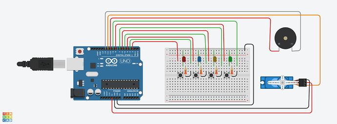

I'm copying an arduino memory game from youtube for school and the issue lies within the piezo buzzer buzzing with a really high pitch as soon as i plug it in, i dont know if its the code since i tried switching it out with the small buzzer you'd put into the breadboard asnd it didnt have that high pitch background noise. my issue with that buzzer is that the volume is too low and the volume of the piezo buzzer would have been perfect if the high pitch background noise was gone. can anyone help?

![Repeat After Me](https://europe1.discourse-cdn.com/arduino/original/4X/1/6/4/1640cd5f01a92a86442d65507130f2c5e4146522.png)
I copied this image exactly (except for the buzzer wires connected to female-to-male jumper cables)
I also tried to run this program in tinkercad and it has that same problem so im thinking i have to change the code

- Place the speaker across the power supply to confirm it is not **active**.
- Never connect inductive loads to the Arduino 5v pin.
- Why is the speaker between two GPIOs ?
FYI

**It's the wrong device.** You want a transducer/speaker, not a "buzzer".
It's an "active buzzer".
...Sometimes it's not clear what they are selling and sometimes the seller gives it the wrong name but in this case there are clues in the description:
Active (it has active electronics inside.)
Input Type: DC (You give it DC power and it makes a sound.)
Frequency: 2.8kHz (A single frequency, not a frequency range.)
Operating Mode: Single Tone (Obvious clue.)

this makes so much sense because the tiny buzzer works perfectly (apart from the volume issue)
how do i fix this and which is the right piece for my project?

-how do i do that? the only way ive been testing my little contraption is by connecting it to my laptop
- Connect the speaker between arduino GND and 5v.
If it is **active** , it will make a sound by itself.
Also, confirm the resistance of the speaker with an Ohmmeter.
-what should i change for it to be the correct way?
- Placing a Piezo speaker between a GPIO and GND or 5v is normal.
The schematic offered you, gives the speaker ~ twice the volume.
Your circuit can increase the volume but it needs 2 Arduino pins.
-im sorry im not really familiar with what a GPIO is
**general purpose input output, pin**
