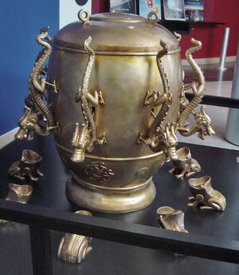

Well, I'm sorry to say, but for me it's still unfeasable, or at least it is not reliable enough for the intended goal, too many variables cound give you false alarms, or, worse than that, missing alarms
Apart from the above issues (the need for at least two sensors, analyze the signals in a sufficient time interval, and do a Fourier analysis..) an R3 or more could be more easily detected using an MPU6050 accelerometer instead of that piezo buzzer, or using something like pendulums, see those examples like [this](https://www.instructables.com/Extremely-Sensitive-Cheap-Homemade-Seismometer/) or [this](https://www.instructables.com/DIY-Seismometer/) one.
Anyway, let me say the ancient Chinese had already realized it centuries ago, and without any Arduino: 😃
