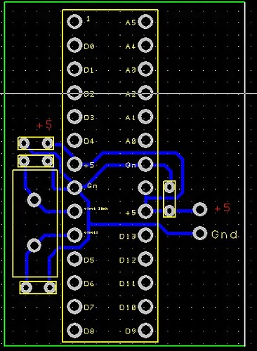

im learning to lay out a pcb and want to put the atmega328 chip into it, i really just want to be double sure on the pin out of the chip, as ive got it layed out on my board
pin8 +5
pin 9 crystal + cap
pin 10 crystal +cap
pin 20 +5
pin 22 Gnd
pin 21 is this pin i wasnt too sure about is it +5?, i see from some guides connect +5 to it - AREF, what does this pin do?

Did you make a schematic? If you upload it, it will be a lot easier for us to see if it's okay.
Nope, that pinout is definitely wrong, pin 8 is GND, pin 7 is +5V
I always make sure I've had a look at the datasheet before I commit anything to a PC board.
Or use the Sparkfun library if using Eagle?
When I use a bare ATmega328 on a breadboard I use this drawing to see the pins:
Very handy because it has the Atmel and Arduino pin numbers on it.
Or copy an arduino schematic as a starting point, delete the parts you don't need.

I think a few corrections are needed:
CTS on the FTDI connector needs to be grounded as well for the FTDI breakout board/cable.
(CP2102 modules don't need the CTS pin.)
Pin6 is DTR.
What's the 10K on the Tx line? That will kill any transmit drive capability.

Why would it do that? Its to protect the pins and allow Arduino pin 0 to be used as an output.
here is my chip layed out whith what i think should be there could someone please verify it please.
thanks
