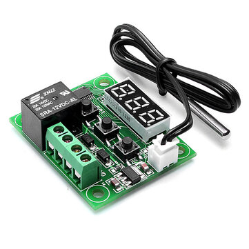

I have a temperature controlled switch and a PIR sensor hooked up to my arduino. The idea is to have the sensor to read motion and for the temperature switch read above a certain temperature, both of these conditions have to be met before the led on the arduino should light up. Yet the problem is that the light comes on even if the temperature switch has not reached its set point that it would write the pin as high.

We need to see what type of thermal sensor and how it is connected.
Weedpharma
I suspect, then, that your switch is wired incorrectly.

I just got the PIR code from the Arduino site. I am using a 12 v temperature controlled switch through a optocoupler.
That doesn't tell us ANYTHING about how you have wired it.
You need to write a sketch that does nothing but read the state of the pin that the optocoupler is connected to, and print that state to the Serial Monitor. When you see that the values printed match what you expect, then change to the state change detection example model, and print only when the state changes.
When you KNOW that the optocoupler is wired, and is being read, correctly, you can put the PIR code back in.
