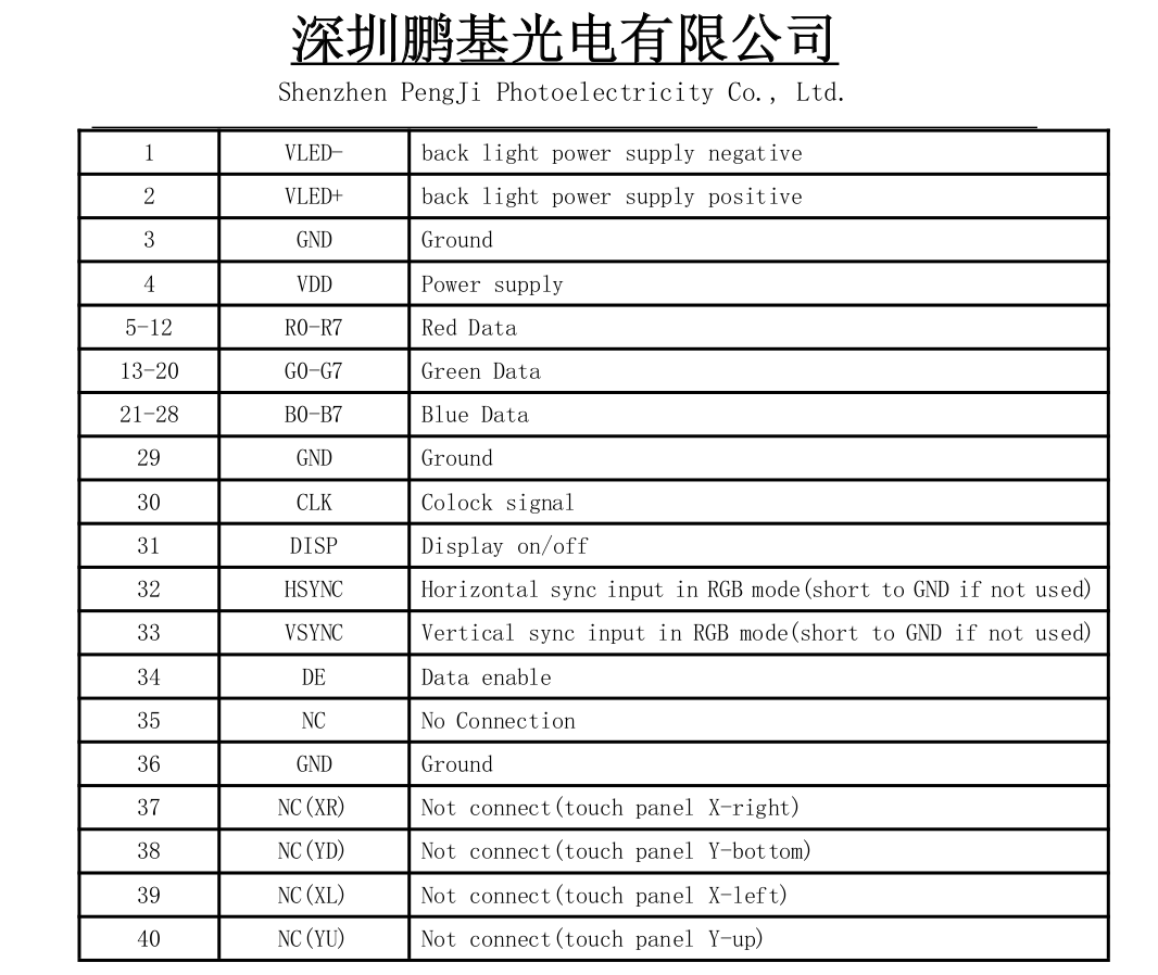

Hello!
I have this LCD PJT1430P01H29-200P40N and would like to know if there is how to use it with Arduino. I didn't find any topics about this particular LCD. Has anyone used it in any project?
I found his datasheet and I'll leave it in the message.
Datasheet: http://f01.s.alicdn.com/kf/HTB1FdCJFVXXXXb9XFXX.PRXFXXXz.pdf
Just considering the nature of the interface, I doubt it would be practical!
What makes me really curious, is that four conductor strip which appears to be the only connection to the display element itself!
Paul__B:
You haven't seen a resistive touch panel before?
To OP: The 40-pin connector is "sorta" standard - Adafruit has driver boards for it, where you can attach it to a Raspberry Pi.
Forget attaching this to any Arduino. The Arduino doesn't even have enough memory to store a single still image.
