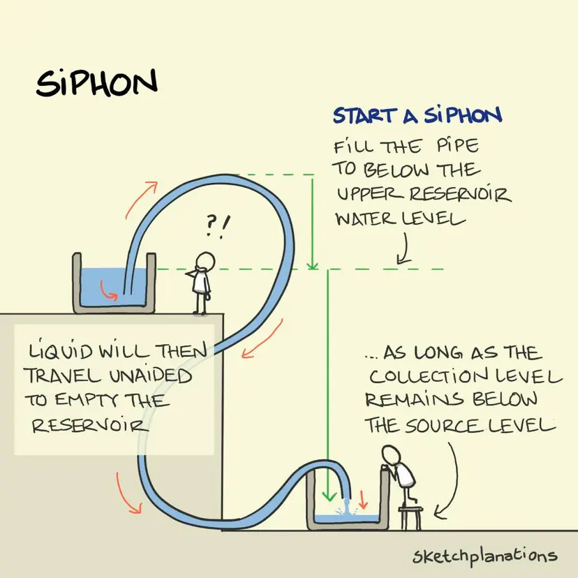

I have the levels set at 30%. I see that the motor stops when the moisture sensor reads >30%. But the water is still slowly coming out of the pipes. This is flooding the entire plant and will eventually flood the floor :frowning:
I previously used the 5V pumps but they were not powerful enough to pump water out of the drum. I noticed that with the 5V pumps when they were not working the water receded back to the drum. In the 12v motor it does not. Maybe that is the problem that water is not flowing in the backward direction once the motor is switched off.

Could be. If the end of the hose that waters the plants is lower than the water level in the drum, the water will continue to flow due to the syphon effect.
You need to post the "thingProperties.h" so we can compile the code and examine it.
I am making the assumption you have installed siphon breakers.
Pin 2, are you sure that isn't reserved?
delay is really bad in most cases but especially cloud. Eliminate them except where you want the water on for x seconds, in that case use millis() and go back to the main loop after checking if the 5 or whatever number of seconds has elapsed. Search the forum for 'several things at once'.
hose that waters the plants is definitely lower than the water level in the drum
That's the problem. Move one or the other, or use anti-syphon/check valves or solenoid valves cantroled by the arduino.
No Arduino involved! My neighbor's solution was simple and effective. They used two pieces of tubing, one slightly larger than the other. The smaller tube was inserted into one end of the larger tube, positioned above the reserve water level. The larger tube was then routed to the plants. This setup creates a vacuum break, preventing siphoning from the main water drum. Simple, effective, and no electronics required!
