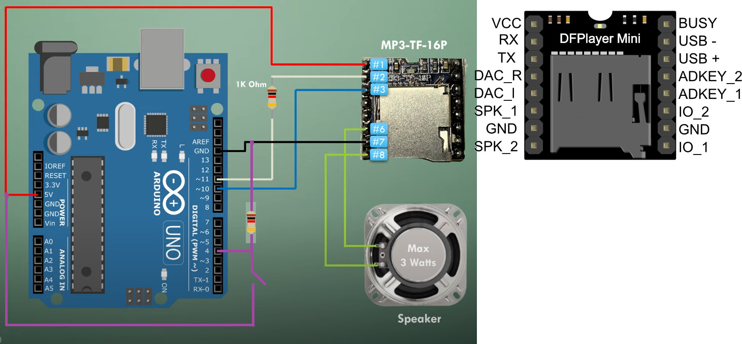

Play audio constantly, interrupt and play something else while button held down
I'm looking to make a toy that plays a sound continuously while on and when you hold a button down, it plays a different audio sound.
I'm using the DFPlayer mini and an Arduino Nano although the diagram shows a regular Arduino, the pinouts are the same.
This is the code that I have so far and the wiring diagram I have:

The code works, sort of. The audio DOES play constantly, and does change when I hold the button down, but only after the first audio file has completed its full length.
The second audio file also has to fully complete, but I want it to change the second the button is held and released.
What am I missing?
Thank you for your time.

    Serial.println("DFPlayer Mini not detected.");
    while (true);  // Halt execution if the DFPlayer isn't connected
  myDFPlayer.volume(30);  // Set volume level (0-30)
  // Read the state of the pushbutton value
  int reading = digitalRead(buttonPin);
  // Debounce the button press
  if (reading != lastButtonState) {
    lastDebounceTime = millis();  // Reset the debounce timer
  if ((millis() - lastDebounceTime) > debounceDelay) {
    // If the button state has changed and it's stable
    if (reading != buttonState) {
      buttonState = reading;
      if (buttonState == HIGH) {
        // Button pressed, play and loop the "rev" sound
        myDFPlayer.pause();  // Pause the current track
        myDFPlayer.loop(rev);  // Play and loop the rev sound
        // Button released, play and loop the "idle" sound
        myDFPlayer.loop(idle);  // Play and loop the idle sound
  // Save the last button state
  lastButtonState = reading;
  // Optional: Print button state to the serial monitor for debugging
  Serial.println(buttonState);
Sadly no joy with the debounce, I'm using a simple tactile button if that changes anything?
I'm curious, the Nano can play simple audio files, and seeing as I'm only using 2 files that are small. Could I completely omit the DRFplayer mini and simply power the speaker through a simple audio amp?
OR do you feel the DRF is my best option?
Honestly, no. I wouldn't recommend that at all. the Arduino itself doesn't make good sounding sounds, only tones.
The DFPlayer isn't super fast. If you send too many instructions too quickly, it will ignore the second instruction.
Maybe this will fix it??
#include <SoftwareSerial.h>
#include <DFRobotDFPlayerMini.h>
// Create software serial for communication with DFPlayer Mini
SoftwareSerial mySoftwareSerial(10, 11); // RX, TX
DFRobotDFPlayerMini myDFPlayer;
const int buttonPin = 4;  // the number of the pushbutton pin
// Variables to track button state
int buttonState = 0;        // Current state of the button
int lastButtonState = 0;    // Previous state of the button
unsigned long lastDebounceTime = 0;  // Last time the button state was toggled
unsigned long debounceDelay = 50;    // Debounce delay in milliseconds
// Audio file numbers on the SD card
#define idle 1
#define rev 2
// Button state flag
bool isRevPlaying = false;  // Flag to indicate if "rev" sound is playing
  pinMode(buttonPin, INPUT);
  mySoftwareSerial.begin(9600);
  if (!myDFPlayer.begin(mySoftwareSerial)) {  // Use software serial to communicate with MP3
  myDFPlayer.loop(idle);   // Start playing and looping the idle sound initially
      if (buttonState == HIGH && !isRevPlaying) {
        isRevPlaying = true;   // Set the flag to indicate "rev" is playing
      } else if (buttonState == LOW && isRevPlaying) {
        // Button released, ensure the idle track is playing
        isRevPlaying = false;   // Clear the flag to indicate "rev" is not playing
But I would still expect that when you release the button after a quick press, the rev track will continue to play till the DFPlayer has finished the background tasks it is still doing, though should be very quick.
Let me know if I'm right about that...
:crazy_face:
Sadly it still gets caught up with the button press, but honestly, it's at a stage where the project can progress and fine tweaking can go to the back burner, I will continue to learn and try to find a solution.
Thank you for everything, if you have any other ideas, I'm open to trying :smiley:
