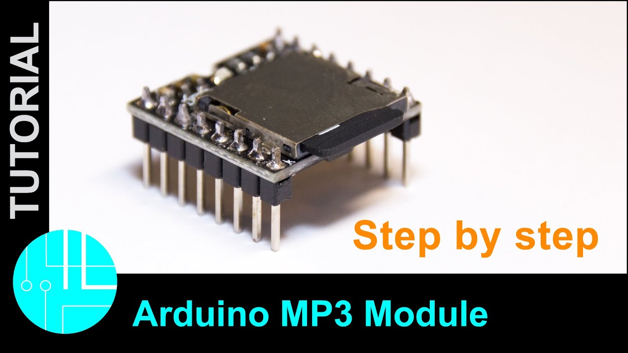

https://www.google.com/search?q=dfplayer+mini+mp3+library
if possible, I would prefer to skip ADC, since I'm decoding MP3 on the ESP anyway (at least when using schreibfaul1/ESP32-audioI2S library). I did take a look at dfplayer, but I though it might be possible to do all on the ESP

With a DFplayer (or similar) the processor doesn't have access to the SD card or the digital audio data so you have to feed the analog back-into the ADC.

in a similar setup with an ESP32 I use a DFPlayer module as recommended by @kolaha in post 2 and the Adafruit_NeoPixel library (note that if you have more than 85 LEDs this library does not work with ESP32 Arduino Core 3.x and I have to use 2.0.17)
