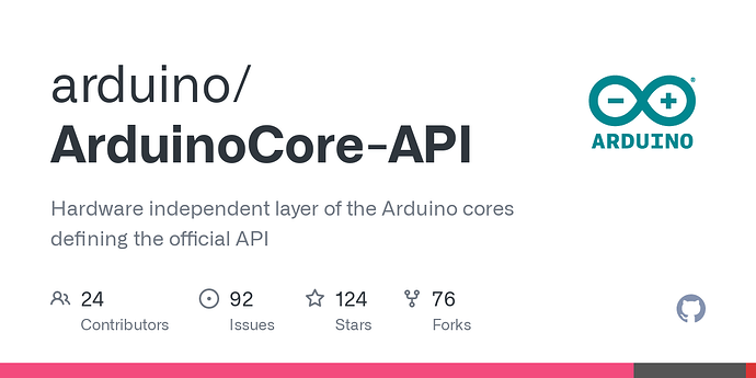

Some of the functions are architecture independent. Traditionally, these were always duplicated in every platform, and you might find that an improvement or fix in one platform hadn't been ported to another. To help resolve this situation, Arduino recently moved all the architecture independent code to a dedicated repository, from which it can be shared by all platforms:
However, this is currently only in use by two official platforms and probably only a few 3rd party platforms, so it would be incorrect to point people to that code alone.
