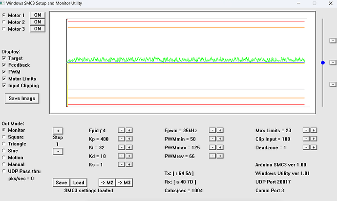

I am using an arduino to control 3 motors on a motion simulator for gaming
I was using elegoo clone with smc3 sketch all was fine till i had a short and pin a0 was just producing noise
So i purchased a genuine arduino
The clone showed green and orange lights and showed up as arduino on comm port 3
The genuine is showing 2 red lights 1 flashing and shows up as serial usb on com port 4
I try to write the smc3 script and it says com port 4 access denied
I can copy the error and paste when i open up my pc
Please somebody help me understand im stuck after doing so well

it works but the pin a0 has a problem just shows noise so cant use potentiometre
thats why i got a new board

the r3 shows up fine on com3 and is showing orange and green lights i can write to it and it can run the motors fine its just the pin a0 is failing to read the potentiometre
this is why ive purchased the new R4 but this new board which is arduino only shows as serial usb it shows on com 4 in device manager and in ide

these are 2 screenshots showing feedback from pins a0 and a1 whe nothing is conected to the pins a0 shows noise a1 no noise which is right
Hi! Welcome to the Forum!
Wouldn't be enough to move the potentiometer to A3 and change this line in the code:
const int FeedbackPin1 = A0;  // Motor 1 feedback pin
to
const int FeedbackPin1 = A3;  // Motor 1 feedback pin
thanx and i did consider this but a3 is used for motor 3 when i build that part
maybe i could use pin 4 bt would that be enough i supose i could try is that the only bit of code to change
im excited to try this idea
And did you make the changes in the sketch to reflect this change?
The sketch in your post #11 clearly states that motor 3 pot was supposed to be connected to A2:
the code was written by someone much cleaverer than me its for a motion simuylater the runs on software called sim tols i know motors 12 and 3 run off of pins 0,1 and 2 ill try changing from 0 to 3 like you sugggest
wooooohoooo
thanx so much it worked i did consider it before but didnt know how
now i see power of code im addicted
thanx for all you help
I'm happy to hear that it worked.
I hope you can fix your problem with the R4 too. After all, it's too good to hang on the wall...
Have fun! :upside_down_face:
