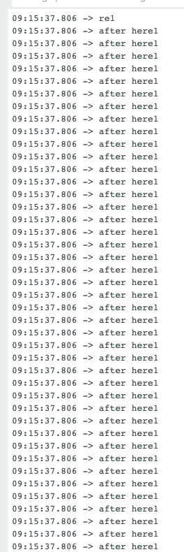

Something odd that is happening is that when the Teensy is powered on the highlighted menu item is "EQ1 Freq" instead of "Low Cut", and I cannot figure out why!
My guess is that the statement following the print I added (commented) is executing upon startup, changing the default option to 1.
I can see you are not using Serial.print. You can verify my hypothesis using the onboard LED or via the LCD display…
Thank you for the reply! That section of code is in a pervious sketch that didn't have the eeprom and display time out and I didn't have that issue then. I used serial print to show the menu selected in that section. (Im not sure if Im doing this correctly).
loadSettingsFromEEPROM();
drawMenu();

And the serial monitor prints this about a million times a second:
I added a delay in the loop and when I first power on the Teensy the first menu item (low cut) is highlighted, and then after about a second it scrolls down to the second menu item! So i assume something is going on in the handle encoder section...

The Encoder constructor initializes the position as 0, which is the value returned by read() if no activity is detected by the encoder: https://github.com/PaulStoffregen/Encoder/blob/master/Encoder.h
Your sketch initialized oldEncoderPosition as -999. In the first close encounter, newPos will be different and the program interprets that the encoder shaft moved.
To prevent this, change this
to
int32_t oldEncoderPosition = 0;
That should fix the issue.
I know the old position is initialized as -999 in the examples. Why? Beats me.
(I’m working off my cellphone, cannot test)
Thank you! That solved the issue. I really appreciate the help.
